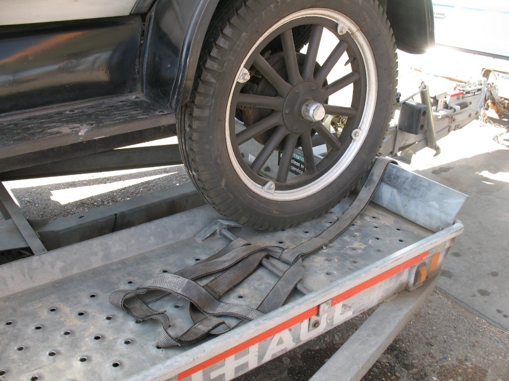

BE_ZERO_BE
- Posts: 654
- First Name: BOB
- Last Name: CASCISA
- Location: POULSBO, WA
Re: Transporting a Model T
I had modern tire wheel nets when I first got my trailer.
I quickly replaced them with some off-the-shelf fully adjustable wheel nets.
The horizontal loop is adjustable and can reach around a T tire easily.
The top over strap is adjustable as well to keep everything snug.
I always check my tiedowns at every fuel stop.
OLD WHEEL NETS ADJUSTABLE WHEEL NETS
Respectfully Submitted,
Be_Zero_Be
						Be_Zero_Be

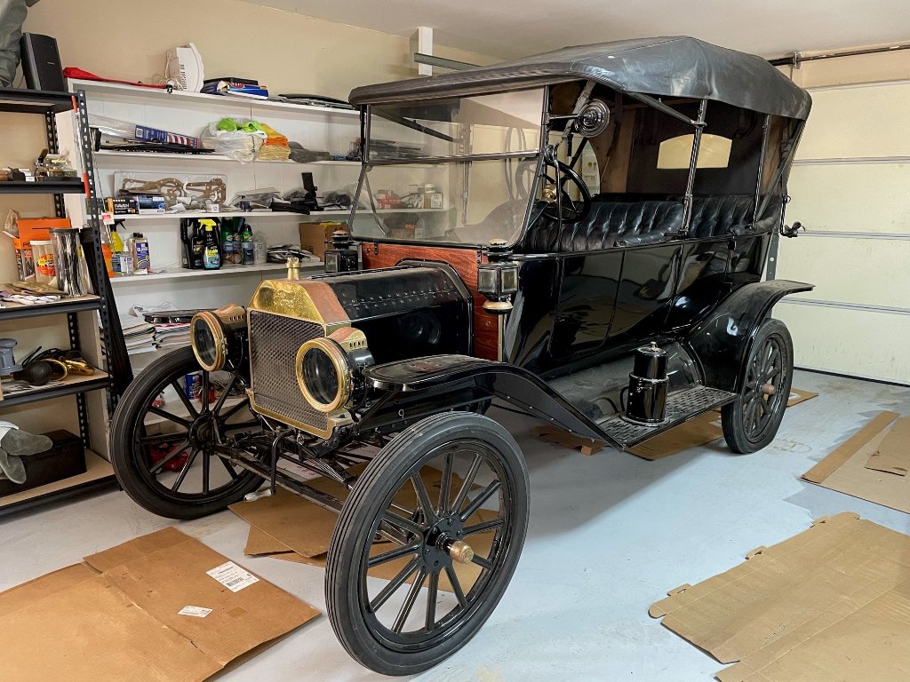

				bdtutton
- Posts: 225
- Joined: Thu Feb 18, 2021 10:19 pm
- First Name: Bryan
- Last Name: Tutton
- * REQUIRED* Type and Year of Model Ts owned: 1914 Model T
- Location: Southwest, MI
I did not expect this many replies and opinions when I posted the original question.  I am fortunate that I have a large enclosed trailer with several cross members under that very thick wooden floor.  I also have a 1930 Model A that I plan to occasionally haul so I positioned the Model A in the trailer to get just the right amount of tongue weight and positioned some large D rings in just the right spot to allow me to cross strap the car down over the springs and put a small strap around the axle at the point where the spring is mounted as a backup in case the strap over the spring fails.
I now have the car I just purchased home and I have started working on it. Fortunately, the main problems are that the top and the tires are shot from age and setting too long, but the previous owner had planned to store it for a long time so the gas was drained, spark plugs out with oil...etc....
