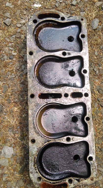

Post by flatbroke3 » Tue May 18, 2021 11:50 am
I have a aluminum head with the usual copper gasket and have water in cylinder two and three. after taking off the head to figure it all out, I found that the water passage in the gasket, between two and three is all gone, corroded from electrolysis? what type of gaskets are recommended for these heads. copper, steel,composite? which one is the preferred type of gasket? don't want to do this again.

Copper is usually the preferred for Model T’s. Probably the gasket wasnt tightened down good enough to begin with or the surfaces weren’t cleaned when installed. Anything that will cause a small leak usually a deterioration will occur over a long period of time.
Others will have their own idea for sure which is best for aluminum heads nowadays but a copper head gasket will last for years and if you carefully remove the head they can be used again but for some that’s a big no-no! In the T era people would use them again if need be with no problem if that’s all they had but that was when they were using the standard head.

That looks more like just a gasket blow out to me...
As I understand, electrolysis occurs when an electric charge is created from a water pump or something rotating in the cooling system.
I would make sure that the head surface is flat as well as the block surface. Be sure to tap and clean out the head bolt holes and torque to 50ftlbs, I actually went to 55 on mine.
Run it at idle till it’s hot, let it cool and retorque.
Drive it and check it again. I sprayed the gasket with copper gasket sealer also.
I have an aluminum head and run a copper gasket with no problem.

Typical blown gasket, right at the typical spot between the cylinders 2 and 3.
There is little wall thickness, and the narrow gasket will give at that point. Best seal is made by following Ford head bolt tightening sequence. Do the center bolt first, then alternate up and down the middle to squish the copper clad gasket in the middle of the head, then move out until the ends are done. That provides the best seal.
Copper clad gasket using copper coat sealer sprayed on each side is recommended by hi-compression head makers.

Or perhaps the OP has issue with the un described high compression head, at least one style has excess casting hole in the head to block interface that caused similar gasket troubles.

well, thanks for all of the reply's so far. just got the head back and it was out .009 I do not think this head has ever been off of the block. I got the car last Christmas, and tracing owner history back, no one can remember ever looking at the oil or leaking head. Found a medium chocolate brown oil mixture in the crankcase when I drained the oil. I do not know the manufacture of the head but it looks just like a stock T head. says made in u.s.a. only. I have on order a zinc kit from the vendors, so that will help some, but as to my real question, has anybody ever felt they had a corrosion problem with a copper head gasket and all of the dissimilar metals ( i am a marine mechanic and that is a very common problem) or is this just a typical head gasket blow out? oh no water pump just a stock motor(don't need no water pump) that's what Henry said. coolant is stock 50/50 antifreeze.

That looks like a blown gasket to me. As the gasket begins to leak, combustion gases are forced into the water jacket causing rapid corrosion. The erosion of the gasket material was probably caused by a combination of accellerated chemical corrosion and the force of the hot, high pressure gases eroding the copper and sandwich material. A slight head gasket leak will often cause the coolant to turn brown or reddish brown, even when the cylinder can still fire. Most likely, dirt, old gasket residue, or some flaw in the gasket surfaces caused the leak to begin. It may have leaked a little for quite some time before it got really bad. Some leaks will only open when the engine is at running temperature, and leaked coolant goes out the tailpipe. Others will seep when the engine is sitting cold, and the engine will miss on start up, then smooth out as it warms up. Electrolysis would affect all gasket surfaces exposed to coolant, not just a concentrated area.

If electrolysis why just there?
Posts: 4110
Re: copper head gasket electrolysis?
Post by DanTreace » Wed May 19, 2021 5:56 pm
Agree. Unusual to blame electrolysis for gasket blow.
Such similar reported gasket blows due to the ‘Reeder’ style alum head to me is identical to this issue.
Note the comparison of the long sunken oval portion of where the gasket failed. The Reeder head has a long oval hole, no other cylinder head put on the Ford has this feature. The engine blocks do not have matching feature.
This sets up a gasket for early failure, seems to me the issue is the head design.

Dan, that's exactly what we found. I believe the void in the head is responsible for the gasket blow, perhaps doe to lack of clamping at that area. I had the void welded up. My mate made a plate and welded that onto the hole. Once the heads were re-surfaced, we had no further problems.
The attraction of the Reeder head is it's imade to resemble the low heads on earlier cars. Mine was on my 1915 speedster.

o.k. thanks for all of the reply's. I have found that the head is not a reeder (at least it does not say reeder inside ) but does have the same type of hole in it. I will proceed with having it welded up and go from there.thank you again for all of the help getting to the bottom of all this.
