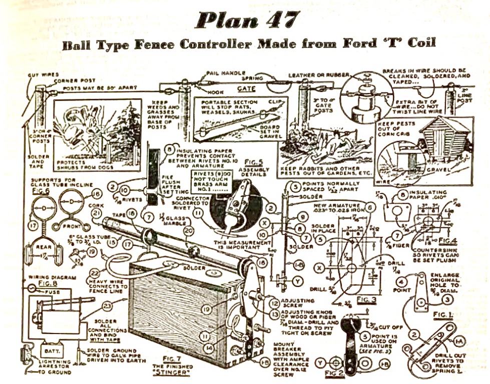

Here’s the drawing from the Lejay Catalog.
Lejay also made a kit.

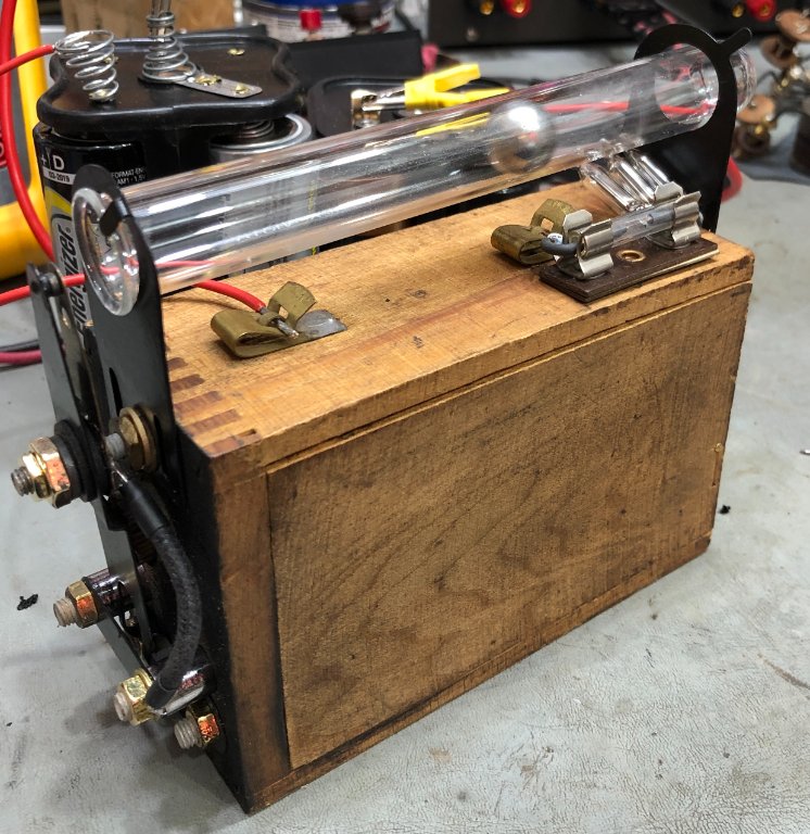

got one that was missing tube found that a rain gauge tube works fine. use glass marble not ball bearing.

A Test Tube works great for a glass replacemnet.

If anyone does not have a LeJay manual, you need to get one. Lots of info!
That is where I learned to rewind generator armatures. Has info for all types of early auto electrical. You will be surprised what you can make out of a T generator or starter. Dan

the fuse Is a good addition. when I got mine the points were welded together and the springy part witch the ball hits was burned in two. had to make a new one. a rain gauge tube is about the same length as the coil box looks neat except for the numbers. ;)

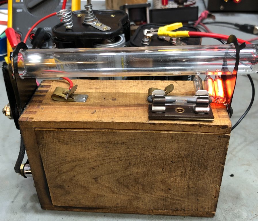

The "fuse" is actually the glass from a fuse with two electrodes and a spark gap inside.
In addition to the three neon light bulbs, it is an visual display of the spark when the coil fires.
