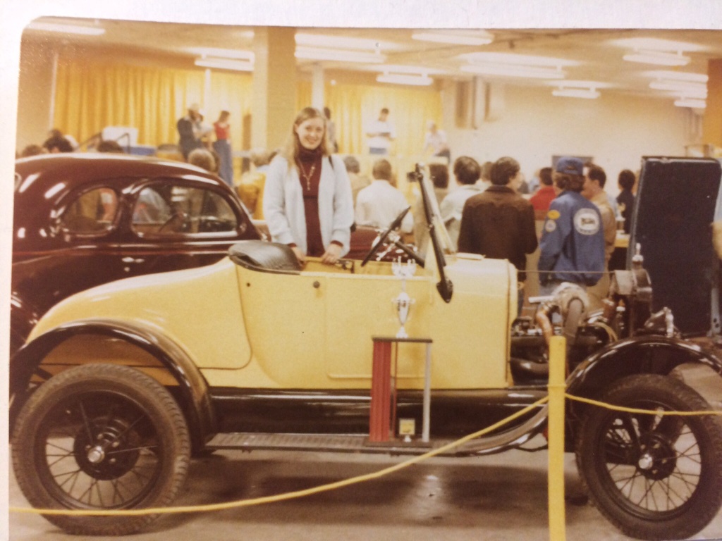

In my opinion (and experience), modifications should be considered a “package”, if you want to get a decent driving car. Attached is a picture of a modified T engine I built in 1978!

Re: Thinking about a downdraft manifold and carb. Any suggestions?
I ultimately moved the engine into this car and changed to a Stromberg 97 (flathead V8 carb). Car is capable of 100 mph!
