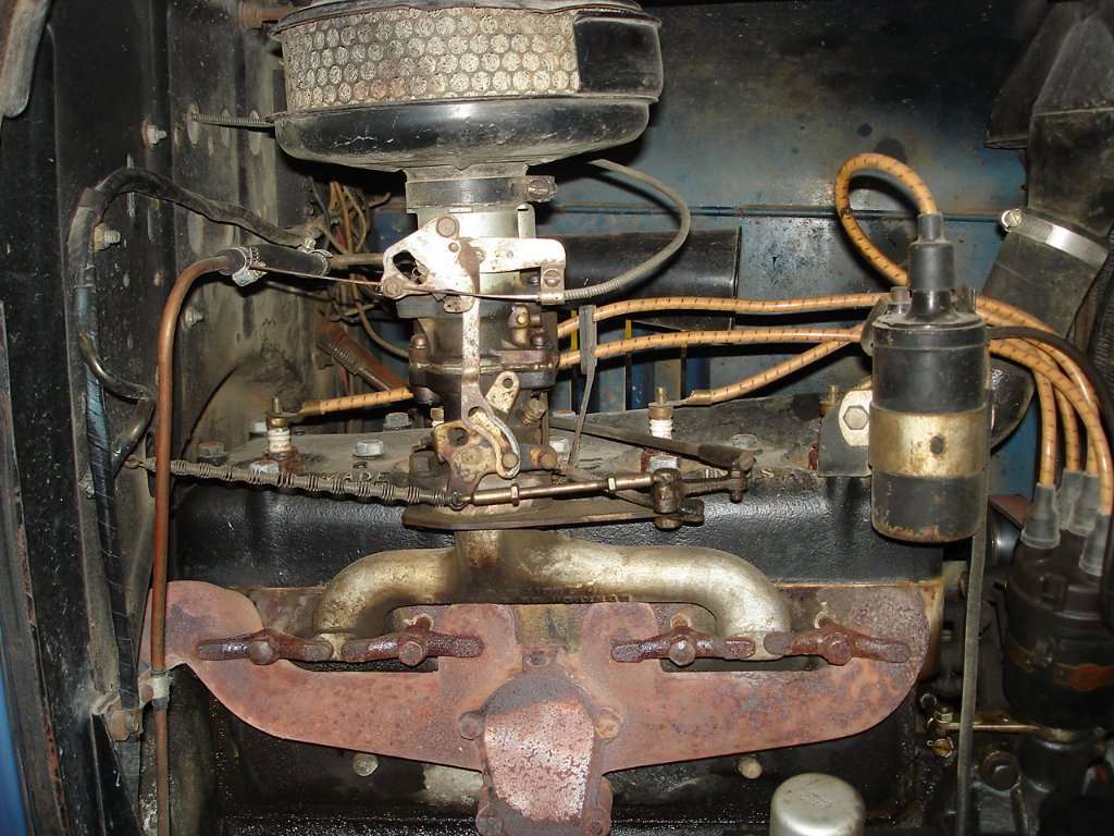

Just for interest speaking of different carbs, this is a SU I'm fitting up on my Speedster. The motor is pretty much stock but for Chevy valves, aluminum pistons, stock cam grind with a advanced gear and a low head plus a distributor. Ran pretty good with a Simmons carb. Interested to see what the SU does for it.
