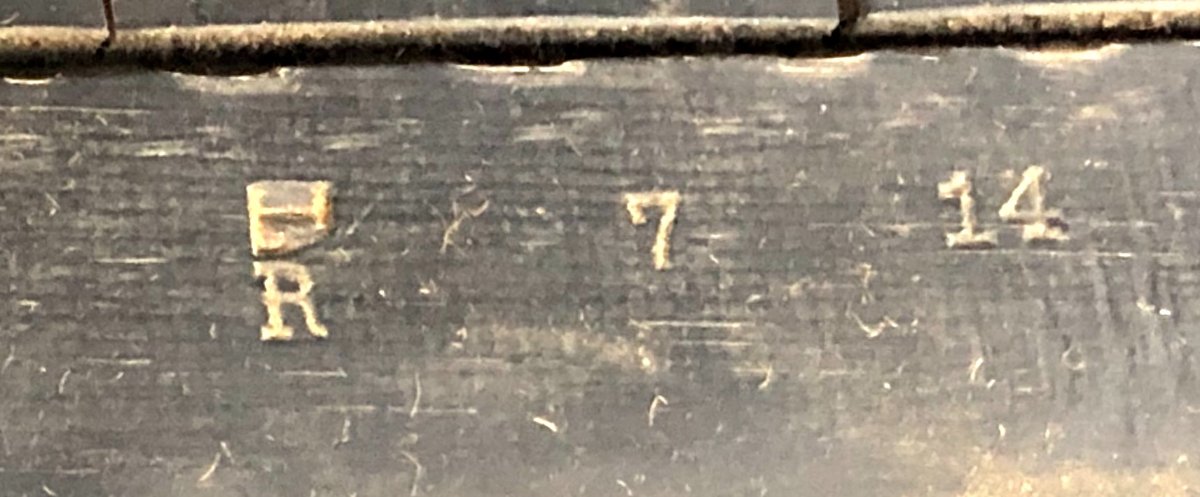

Can anyone tell who made this body? Is the 7 14 a date?
Paul
1914 Touring Body Manufacturer?

Pretty sure the 7 14 is July of 1914. The body could have been installed anywhere from late July into early 1915. However, usually, bodies in that timeframe went onto chassis quickly, most likely before the end of August.
As for the "R"? I will probably hit me upside the head and say "DOH!" when I read the answer, however off the top of my head I do not recall who that could be?
What I find really interesting, is that it appears someone scratched out the original letter, and replaced it with the "R"? This could be an example of a body built 'in the white' which means an unfinished body. It could mean either paint or upholstery or both along with other detailing that would be done by another local supplier. Ford was using bodies faster than the body suppliers could finish them. So sometimes lesser builders would be used, or even the usual major builders would build an unfinished body and then send to to one or more smaller companies to complete the job. Sometimes this resulted in delays, which could make your body installed a month or more later.
The change in the letter could also mean the body was somehow defective, and set aside to be repaired by someone else before it was installed onto a chassis.
Ford was doing what nobody had ever done before! They were building so many cars so fast, that keeping all the needed pieces flowing was a major problem. A lot of short term solutions were needed before Ford built enough manufacturing facility to do most of it inhouse.
So. More questions for you to ponder. And a really interesting model T!

I'll shoot some close up pictures of that mark above the R. Possibly its just some sort of damage.
Paul

Look at the top center of the "heel kick panel" metal stamping, front and rear.
Sort of tucked up under the overhang of the seat frame.
The letters are often stamped in the metal, "B" for Beaudette etc.
Herbert, Hayes, Fisher, Monroe, Ford, Pontiac (Beaudette), Wilson....
Maybe HR for Herbert ?

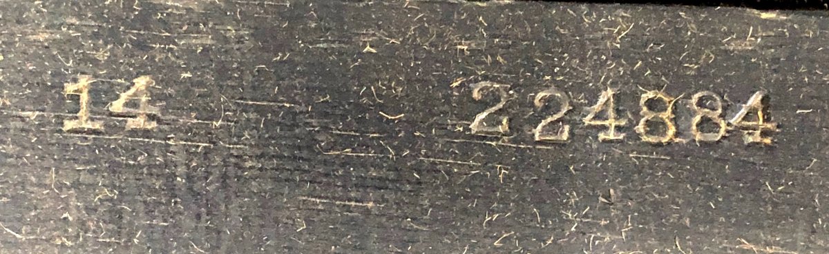

I had a look at the steel heel board in front with a good strong flashlight but did not see anything. I'll check the rear one latter.
I did shoot a few more pics of the stampings in the wood. Its not clear of the mark above the R is a stamping or just a mark from some sort of damage.
The body is in pretty good shape with a lot of wood that looks to be original.
Paul
Paul
