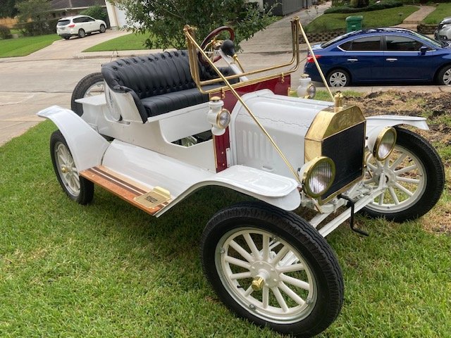

Coming back together again. If I get the wheels painted I may have a roller soon.

And the wheels are finally painted. Wow that was a lot of work. I will let them sit for a week to cure.

One wheel completed I think. See attached.

Three wheels are on. Back to the drawing board on one front wheel because the 'Bimel' does not look like it fits. First fender test fit.

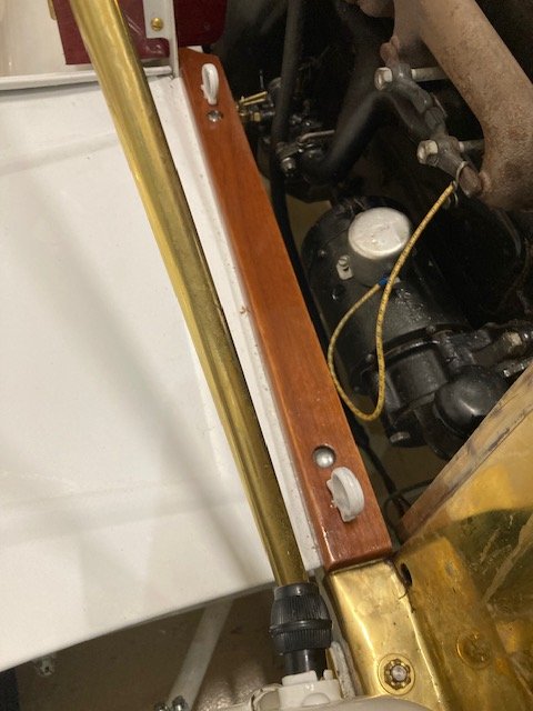

The firewall is installed.

Ignacio, If you are using a brass radiator and the later type firewall brackets you should make sure to mock up the hood, hood former, and hood shelfs. Make sure you can open the hood with out hitting the fire wall brackets. I see you have them mounted like a 1926 car, that might work to clear the hood, I don't know. The stock 1917 to 1923 brackets for a wood firewall are diffrent thain the later brackets due to the wood firewall thickness. You may need to mount the firewall brackets like the 1917 and later cars or go to the repo 1916 or earlier brackets and drill the frame to mount them. Your car is coming right along, keep up the good work.

I see the firewall is not bolted to the brackets. That is good. First you need to get your hood former and see where it fits. You may find that your vintage brackets may need to be swapped from one side to the other to fit under the former.
Also, the firewall needs to be cut out above the frame rail, enough to allow the pan ears to slide forward when removing the motor for any reason. otherwise the firewall will need to be lifted if ever the motor needs to come out.
Hope this helps.

She rolls! Got past the Bimel wheel saga. Did the bearing grease ziploc bag of iniquity on the front two wheels so we now roll! Also worked on the seat. Stripped the Bondo, relminated the pieces that were coming apart. Pulled tacks and nails. Filled the holes with wood filler. I pondered the threaded sockets no doubt for a top but what plugs into the sockets and what kind of top? on the Mystery seat.

The fenders running board, firewall, steering wheel, steering column, hood former, headlight buckets and gas tank are back from the body shop.
A lot of the details of the body are ready, holes are filled, ready to prime.
Paint stripped. Reusing old-growth wood trim from a discarded door frame found in the neighbors trash pile. -

Goll, Doc that car is beautifu...wait a sec.
I'm a dumb dumb and don't recall spit. Is that genny grounding wire up to the manifold on the output of the cutout?
I'm wrong more than right yet might it be on the input to the cutout? Chastise at will. Too thicked skin to get an owee.
Man, what a gorgeous project.

Thanks Duey she is a fair lady. That is how Ross wired it for now so I presume it must be right. The idea was for me to later ground it properly.
Duey_C wrote: ↑Sun Sep 26, 2021 2:35 amGoll, Doc that car is beautifu...wait a sec.
I'm wrong more than right yet might it be on the input to the cutout? Chastise at will. Too thicked skin to get an owee.![]()

Except for a few details I think it is done. And it is fast for a model T.

Re: Hay wagon to Speedster Project.
And to think it started like this!
Well done my friend!

Thanks JT couldn't have done it without you and the rest. Some more details today. Lame attempt at glamor photo. Fire extinguisher is mounted. Tail light works. Wearing all its brass bling now.

Before and after. Love it. Now all that hard work can be enjoyed. What a nice look. Have fun and keep us posted on your adventures.
