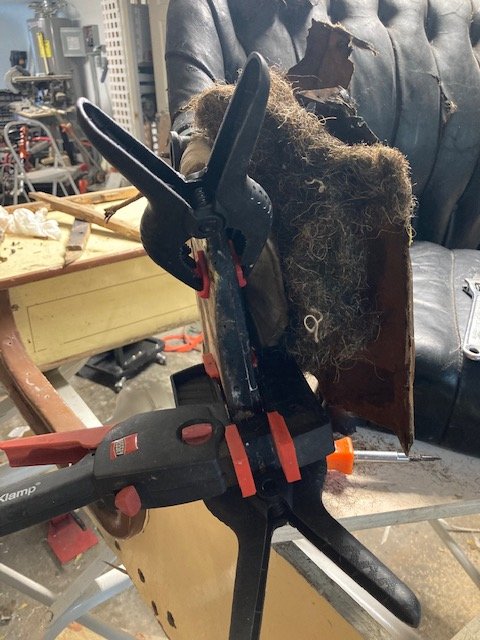

The seat looks like porcupine quills. Those are toothpicks dipped in wood glue and pushed into the old tack holes so that the new tacks will stay firm. They will be clipped off when dry then sanded down. I didn't want to wreck the 1912 body I have by modifying it as a Speedster body. It also has some delamination issues to repair and paint to strip so I am just building a new body which so far isn't too difficult.
- Posts: 4243
Re: Hay wagon to Speedster Project.
The sockets on your seat are indeed for top bows. Have a look at photos of Buicks from the 1910ish era. They used these sockets. Maybe your seat is from a Buick?ivaldes1 wrote: ↑Sun Jul 25, 2021 12:38 amShe rolls! Got past the Bimel wheel saga. Did the bearing grease ziploc bag of iniquity on the front two wheels so we now roll! Also worked on the seat. Stripped the Bondo, relminated the pieces that were coming apart. Pulled tacks and nails. Filled the holes with wood filler. I pondered the threaded sockets no doubt for a top but what plugs into the sockets and what kind of top? on the Mystery seat.

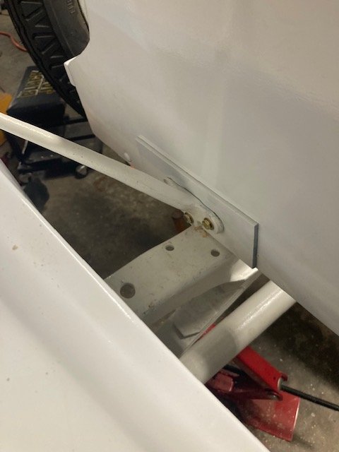

Just following up on your speedster build and noticed an error regarding the rear brake photo dated Monday April 12 2021 1.30am.
I feel that you have the brake lever (could be off the other side) in the wrong position.
In the off position the lever should be close to the axle tubes to give the lever full purchase on the brake shoes.
Others may think different. Keep up the good work...n.

Good catch. there are right & left cams. They got switched.Poppie wrote: ↑Sat Aug 21, 2021 5:38 amIgnacio,

Thanks, I have not riveted them yet so can still switch. Are you saying the brake lever lobe is supposed to face the rear of the car?

Ignacio, I see in the rear cross member picture that the spring center bolt head isn't in the cross member. Make sure when you do the final chassis assembly that the front and rear spring center bolts go threw the spring pads and into the cross members. This is what keeps the chassis centered.

The brake cam lobe faces the front as in the photo but the actuating lever should be facing to the rear towards the axle tube when the whole unit is riveted together, as John (speedytinc) mentioned you could have the cam on the wrong side of the car....n
