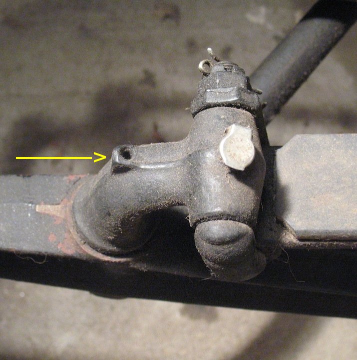

The boss on the elbow of the perch goes to the rear.

This illustration shows the boss lug, with is used for lathe turning, that boss must be to the rear of the axle.

I'll take another whack at this dead horse. :)
The arrow points to the part that goes toward the rear of the car.
