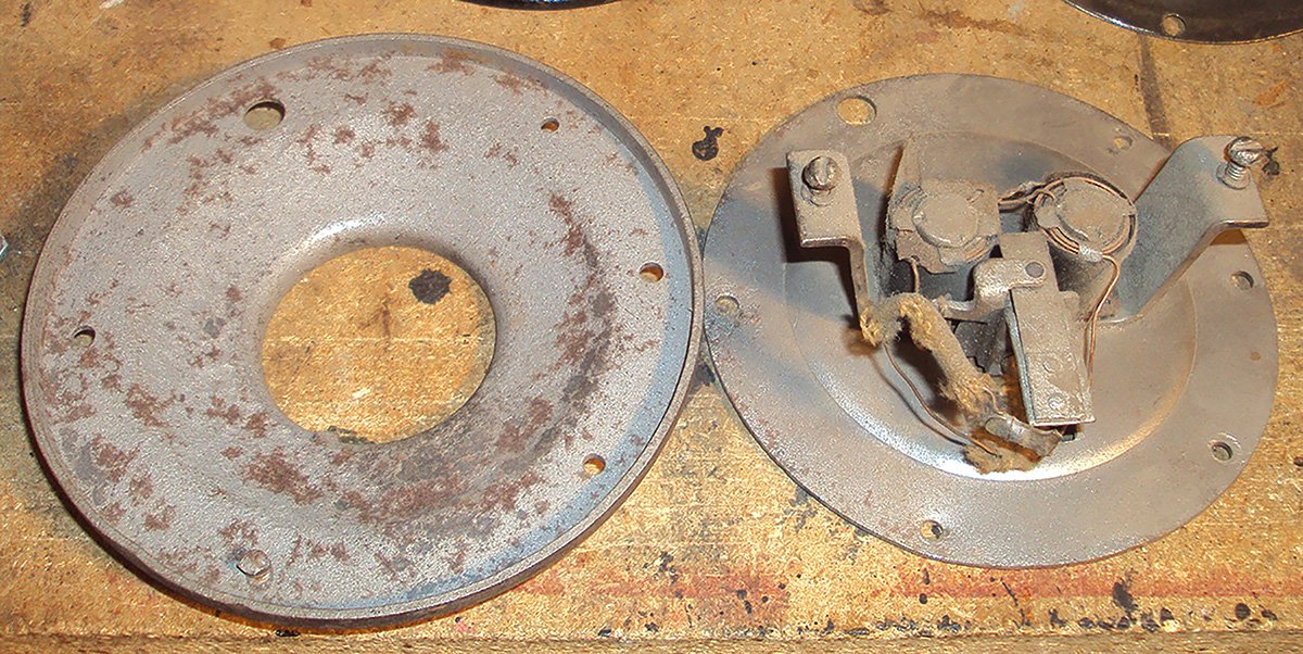

This is what I've got so far.
So any information as to the size of those terminal screws would be a big help....also would like to know the size of the Adjustment Screw as well.

Here is what my vibrator plate and screw measured. The other two look the same looking down inside. The slot in the adj. screw is about 1/16" wide and deep.
Also, the small diameter of the Horn bell is 1.83 where it goes into a flange 1.88 dia. x 3/8 high. The flange is bent 90 degrees from the housing that bolts to the diaphragm and rear housing. I'll leave this horn apart if you need anything else.

Rich, can you show me a picture of that bell and housing flange? Is it soldered to the flange or is there a screw?
Also does anybody have any information on the single pole HECCO horn? I've got some pictures, but are the screw sizes the same? Also need to know about the mounting conditions of it's bell as well.
Fun never quits!
Re: Magneto Horn Bell Screw Size
Post by Rich Eagle » Sat Dec 11, 2021 9:36 pm
Here it is. The entire length is 8" inside measurement of both pieces. The large end measures 3 1/16" dia. (average) It is spot welded in 4 places or maybe 5. It is 1/8" to 3/16" (varies) short of the radius in the end flange.
The left flange is also 3/8" and has ford script. The painted one is similar with no Ford script. The right one is an AMES (PAT APLD FOR) and is 3/16 long. Smaller spot welds. Only one of which is still attached. You can see a remaining rivet in the Ames.
Notice that the two lower flange plates (Ford & Ames have one larger hole (5/16") in place of a regular screw hole. The 3 screw holes for the bracket are 1 1/2" apart in all of these while the other holes are 2 3/16 apart. The Ford script flange plate has an additional hole 1 1/2" from the last bracket hole. The black horn bell and flange only have the holes where you show them in your drawing.

Rich, how about this? Still don't know what that larger hole is for or which side it's on either.

That's looking darn nice. I haven't seen the Ford script there. On My last picture it is near the lower left corner of the enlarged view of the script. It's about on the housing bolt circle. The spot welds don't actually show. I'm not sure if showing them would be confused as something else. As for the sound, my first one with a weak magneto sounded like a coil buzz. My better one is louder and sounds like a variation of the bulb horns. Steve's solution is more satisfying and the action of it or a bulb horn is visually nice. However the mag horn sound is original and some will like it for that reason.
As for the 5/16 hole, I wondered if it could be a different terminal location. I have a diaphragm with a 5/6 hole in that location and a second one opposite side (symmetrical). It doesn't have an adjusting screw in the middle or even a hole. Another just like it with a just a hole in the center. I haven't seen a bell flange with a hole there though.

I just discovered this magnet mounting goes with the Ames flange and probably the last diaphragm I mentioned. At the bottom of each piece you can see the remains of a rivet and the disturbed hole it was pulled through. The windings are very different and the rear cover would be larger than those previously discussed. Perhaps something like the Heco horn. I don't have any other parts to it. The single wire may go to a terminal through the 5/16 hole. Which says it grounds thru the bracket.
No help for the illustration but if others are following along it adds to the mysteries.

I have one Steve, you saw it when last you were out here, it is on the drivers side panel just ahead of the arm rest, but when you last tried it, it didn't work (had to replace the jam nut on the tuning screw)....anyhoo, yours sounds like your adjustment is a wee bit too tight, mine actually makes an aaah-ooo-gah sound when you mash down on the plunger. Back yours off one half turn and see what it does then, if too weak, try a wee bit tighter and keep experimenting with it until it sounds right. By the way, you may want to make a tool for tuning it (if you haven't got one already), it's basically a cheap hollow spin tight, that I drilled a hole through for a really long screw driver....makes it a lot easier to tune the horn.
Rich, looks like they've put the windings on their diaphragm and that clacker (riveted long strip) translates the vibrations down through the brackets making the diaphragm into a soundboard, the cover is supported up off the diaphragm on those uprights....would love to see the cover though, would really love to see how this thing works.....I think I may need to make another drawing....every time I think something is really simple to draw, up pops something else that proves me wrong, well...fun never quits ya know. :D

I don't think it's the diaphragm but an additional plate. I was assuming the diaphragm at lower left went with it but I'm not sure how it would assemble. All the holes line up as does the diaphragm just like it without a center hole. That one was sandblasted like the flange and coil plate. Perhaps they went together.

Rich, I don't know, it has a raised center portion, yet has no contact part with a diaphragm to make the noise, to me this suggests that, that raised portions acts like a diaphragm only instead of vibrating it amplifies the sound from that clacker on the back of the windings bracket. You might want to assemble it and see....if it makes no noise, then assume it needs that diaphragm...but a diaphragm would to be insulated from the both the plate and the housing (the gaskets) to vibrate. Would really love to see this thing or one like it, to fully understand how it works.

Hi Martynn,
I remeasured this for a different post and realized the thread is actually 1/4-32tpi. .240 seemed closer to #12 but it is in fact 1/4 on this.
