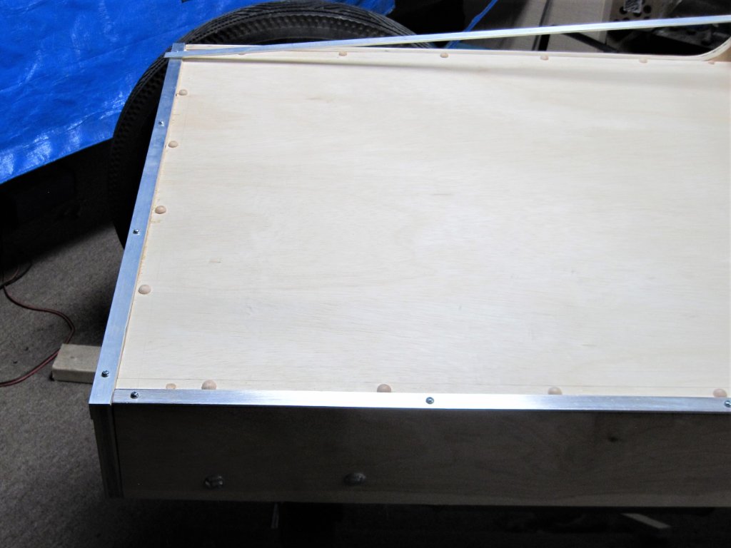

Nice cars posted so far, for the most part they look to be period mods. Kevin, looks like you have some steering rod chatter.
Picture below is my start point today.

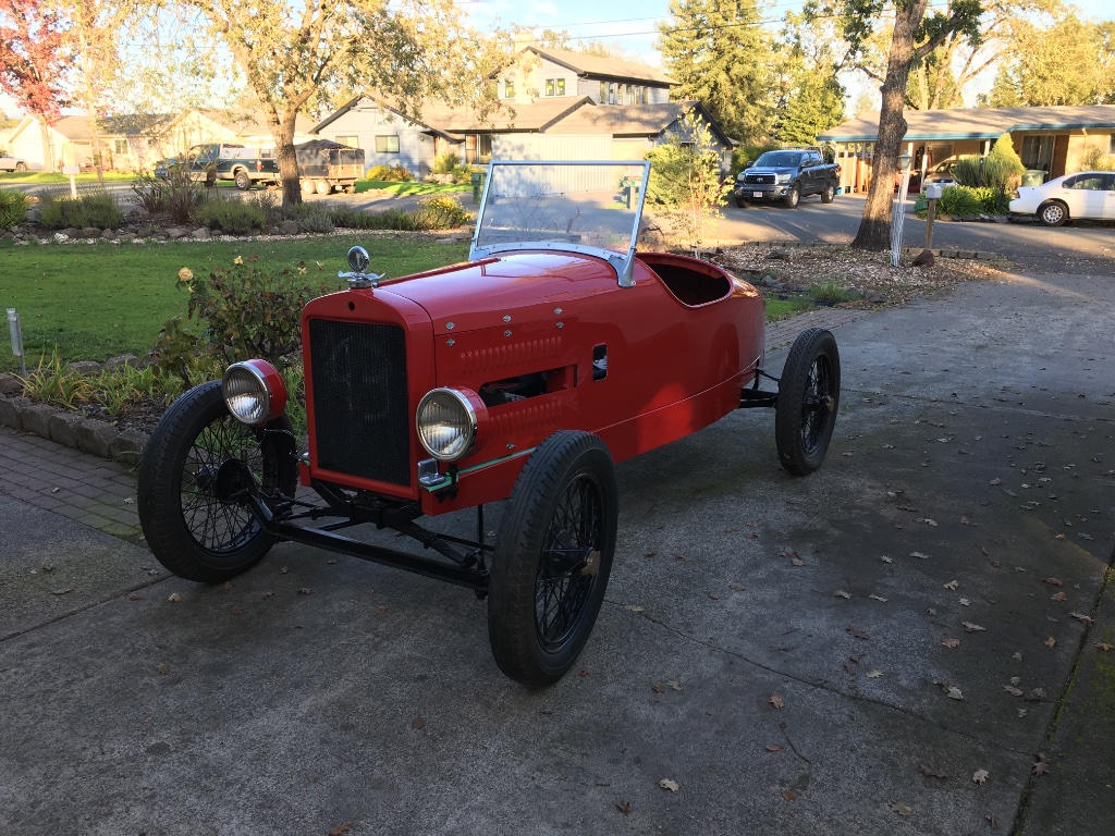

Les is right about lowering too much. I can scrape my drain plug on a speed bump of I am not careful.

Then when speedster events happen it is fun to see them in person and see all the different configurations people do with them and get ideas or just admire.
Tim

Yesterdays progress , going to get more wood in a bit. Finish dry fit, take it apart, glue and fasteners and reassemble, edge trim and the list goes on.
Replacement top half of hand brake also pictured.

Dean, gluing and screwing sounds good, but may not be. The Ford frame will twist, quite substantially on uneven ground. The body needs to allow for this. If it is too rigid it will try to tear itself apart. The better built commercial bodies built back in the days were mortise and tenon jointed and then screwed. This allowed for flex.

Re: 'Speedster - photos and thoughts on lowering or not
Started fitting the aluminum edge strip, flat bar stock on top edges to protect wood, center floor panel is U channel that adds a little support and protects edges, U channel permits hidden screws. Worked on firewall (dash) and put steering column in to see how much of a wedge I need to make for the 1 1/2" steering wheel drop. Have to chase down some slot cap screws for the trim (fitting with Philips) . Not looking forward to taking this apart to paint.
Dean very nice work.
My youngest son and I have a lot of miles of father/son time in our speedster. We put over 10,000 miles on it the first year we had it with 30 miles here and 50 miles there about three to five times a week. If I would have known we would have had such a great time and learned so much during those trips, I would have bought a car 15 years ago.
Very nice, a small thing I like is the use of the hood latches (can't see if springs are on) to hold lower end of hood straps and if springs are still on even better.
