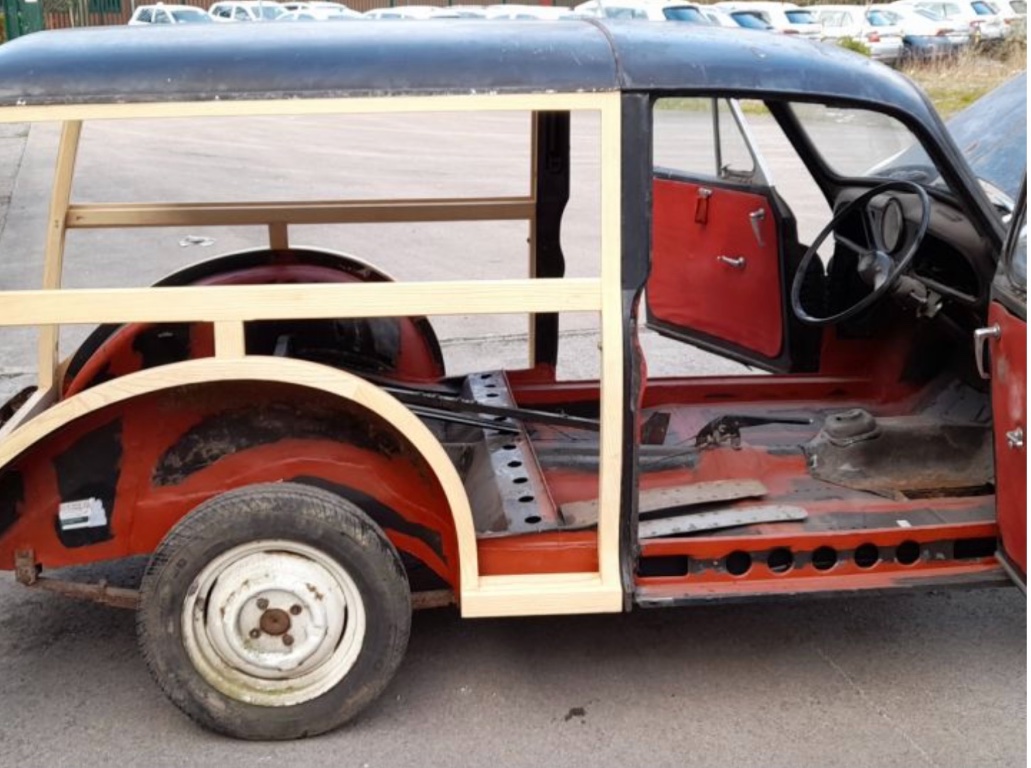

Yep. three down and three over is a somewhat nicer version of mine.
The frame is installed. The installer did the best he could with a janky kit from a well known Morris supplier.

That's not correct. The framework is structural. The panels are infil. The vehicle is unibody as in does not have a separate chassis but from the front cab section back the Ash frame is the body structure.Allan wrote: ↑Sun Feb 13, 2022 6:10 pmIt might help if responders were aware of the car type and the woodwork function. A Morris Minor traveller is a 1960's -70s car. As such it has a unitary body construction. The timberwork on them is purely decorative, fixed to the outside of the panels to give the impression of an external frame.
So, the timbers don't move or flex on the body. They are non structural, the joints don't take load, so gluing them can be done. Peter came up with the best solution to closing the gaps in the joints.
https://www.footmanjames.co.uk/assets/i ... resto2.jpg
https://www.morrisminorowners.co.uk/swa ... dframe.JPG

Yup, sure looks structural to me !

My apologies folks. My first hand experience with the Austin 7 mini traveller is different. In this case, the mini traveller is based on the mini van. The timbers are purely decorative in this application. They were affixed to the body with screws through the bodywork from the inside.
