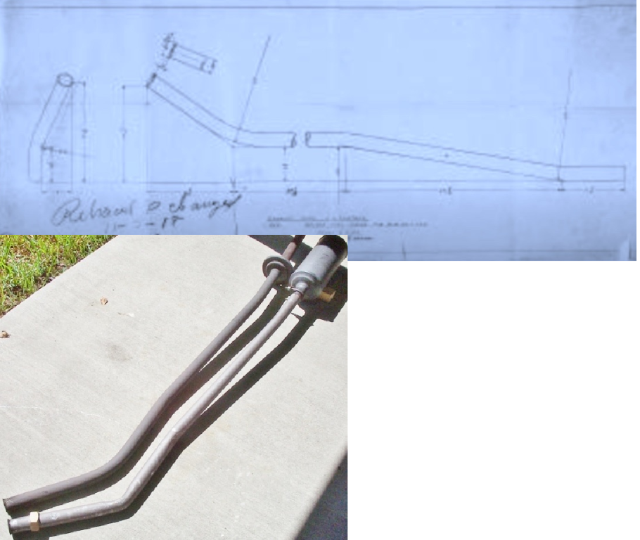

Several discussions this may help
http://www.mtfca.com/discus/messages/50 ... 1450198042
That was contained in this link which discusses eaxhaust pipe bend
https://mtfca.com/phpBB3/viewtopic.php?t=4860

The exhaust pipe should be snug but not be clamped to the muffler at that point. One thing I might suggest would be to get a good tin can and cut a piece which you can wrap around the exhaust pipe and slip it between the muffler pipe and the tail pipe. Then put a clamp around the can and the exhaust pipe, but let the end in the muffler un- clamped. That way the fit will be a bit more snug but still be able to move inside the end of the muffler. Sometimes the bend on the pipe between the manifold and muffler does not fit because the frame sags on the right side. This is caused by torque on engine and also by torque caused by the transmission brake. Both tend to lean the engine toward the right and eventually it will sag on that side. And the the steering will even pull to one side. It might even take some shimming on that side of the body to get the doors and hood to fit correctly. Shims and different bend on exhaust pipe are temporary fixes, but best corrected by straightening the frame.
