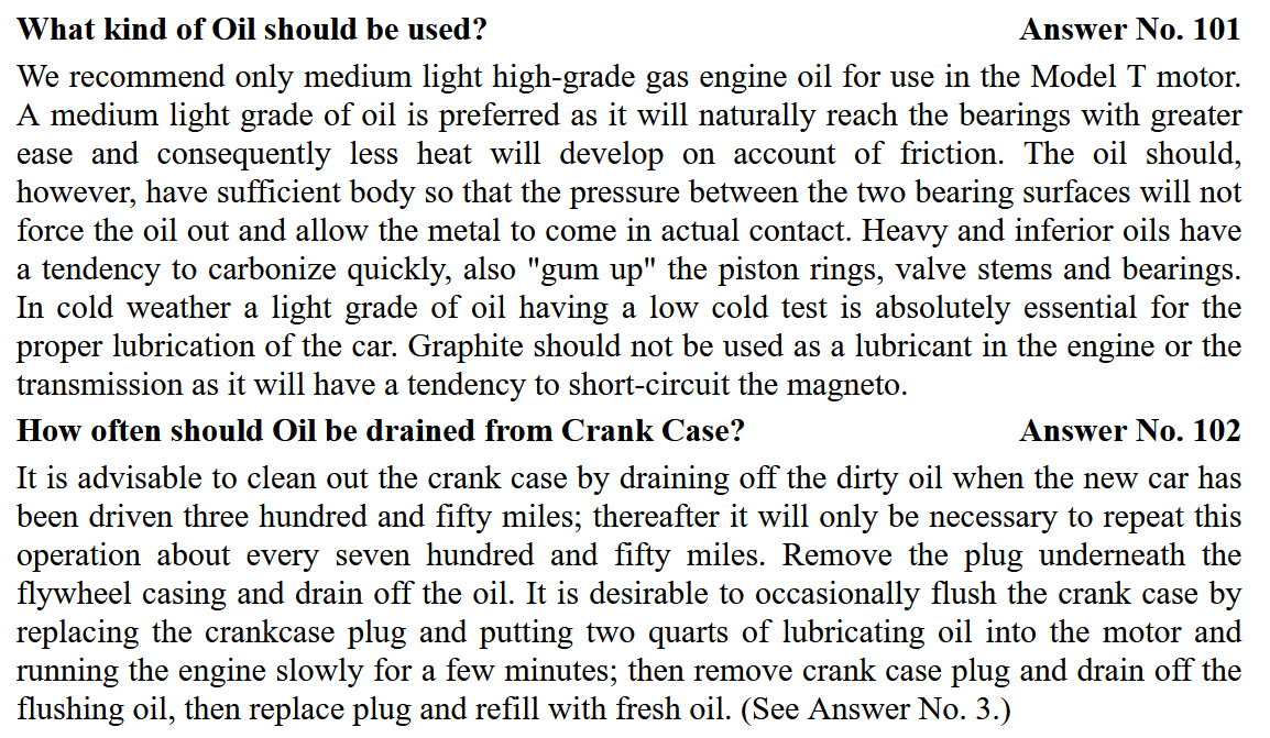

1925 Ford Owners Manual on -Engine Oil maintenance - http://www.cimorelli.com/mtdl/1925/1925manual.pdf
Moxie26
- Posts: 2079
- First Name: Robert
- Last Name: Jablonski
- Location: New Jersey
Re: Oil capacity for the Model T engine.
What year copyright is that from?
- Posts: 6609
The one above was from a 1925 Owners Manual http://www.cimorelli.com/mtdl/1925/1925manual.pdf
The 1926 manual says to use oil instead of kerosene
date 0f 1925 (12/1/1924 The one below is from the 1926 Owners Manual as a reference in the MTFCA Library https://www.mtfca.com/books/1926Inst.htm

Thanks Scott. I thought I just responded to his posts on what the Ford Manual said about draining the oil hot or cold and a second about what edition the 1st Referenced manual was.

32 posts re oil level, says me in dumbfounded amazement. Why not add type of oil to the thread and make it a real barn burner!
