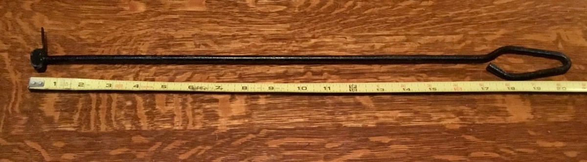

Some of the early accessory oil check sticks have a wire about two inches long that swings around to push the dirt out of those oil drain holes.
Others have marks for the gas tank fill levels.

Topic author - Posts: 2434
- Last Name: Patrick
- Location: Bartow, FL
Re: Oil capacity for the Model T engine.
Earlier, Jim Golden mentioned a measuring stick equipped with a wire to clean out a plugged petcock drain hole. That reminded me of an original Model T combination tool that I found in the trunk of my ‘26 coupe when I bought it in 1970. A 20.5” long petcock opening tool with a 1” long poker that is used to clean out a clogged petcock hole. This is very handy for opening the petcocks without having to crawl under the car. Jim Patrick
