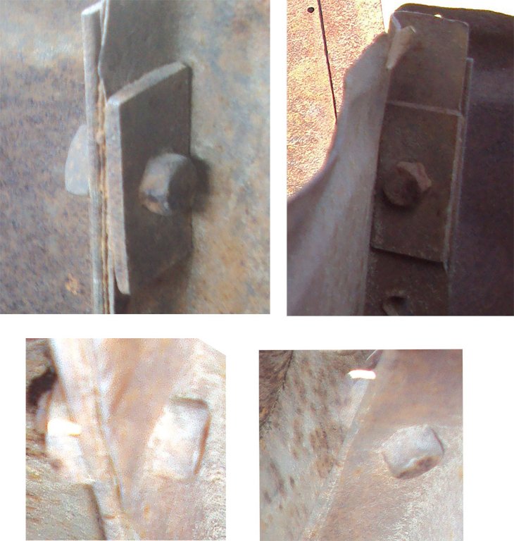

Post by Rich Eagle » Sun Apr 17, 2022 6:53 pm
These are on a later ('23 to '25) body. I hope it helps.
What I thought was a '21 was spot welded. Not sure when the change was made.

Thanks Richard, are both sides with the screw head toward the side of the body and are the nuts all square? Just curious as to the method of assembly, perhaps it was somewhat consistent.
Re: Body Joining Screws 1921 Touring
Post by Rich Eagle » Mon Apr 18, 2022 2:31 am
I only uncovered the portion shown. I assumed both sides were the same with the small bolt head on the center panel side. If I get a chance I'll try to get pictures of the other side and the rest of it. There are several panels covering it.

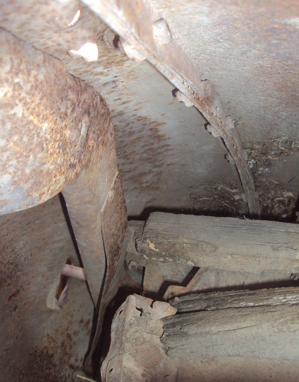

The above photos are what is in my 1925.

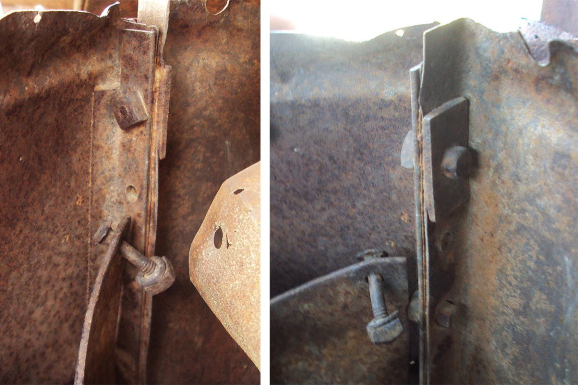

Post by Rich Eagle » Mon Apr 18, 2022 12:41 pm
Here are some more pictures. It is a tough place to get a camera and keep my balance so excuse the poor photography.
You can see they are the same with the small bolt head towards the center and the Square nut outside. My guess is the bolt heads are 7/16 and the nuts are 1/2 but someone who knows should verify this.

It's hard to see but it appears like they are slotted head machine screws with square nuts, correct?
Post by Rich Eagle » Mon Apr 18, 2022 12:56 pm
No, they are hex head bolts. There are no slots.
Yes, they are hard to see in the photos. The heads are a bit rounded but are hexagonal.

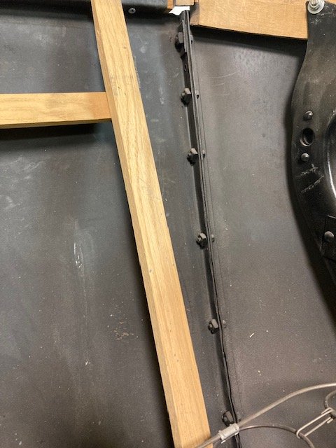

Post by rickd » Mon Apr 18, 2022 1:17 pm
These are the back panel joining screws on a 25 Touring I'm working on.

Post by rickd » Mon Apr 18, 2022 2:21 pm
Dan, I will measure the bolt head size when I get back to my shop. To Rich's point about the installation of the body panel bolts mine are also as originally installed. I can picture young guys spinning them in and cinching up the nuts at a rapid pace probably not caring which direction they go in. You mention you have a pile of original bolts from the previous owners' disassembly of the body. Any of those matching up to we are showing in our cars?

Post by rickd » Mon Apr 18, 2022 3:30 pm
Bolt dimensions: 3/8 x 1/4 x 20. The bolt is 7/8" long including the bolt head. The bolt pictured matches up to the bolts used to put my 25 body panels together. Interestingly, four of these were also used to attach the firewall brackets to the firewall. Its been my experience that a carriage style bolt is usually used for those brackets. My 25 was put together in the last week before they switched to the 26s. Might have been another case of "what do we have on hand" hardware.

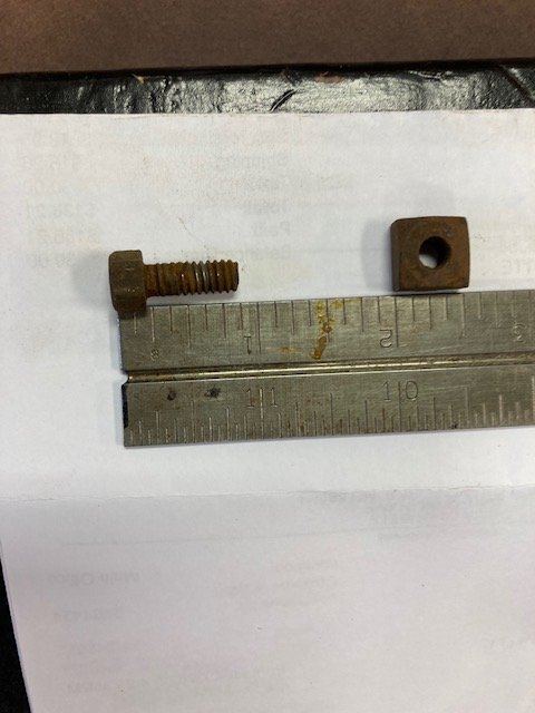

Rick D
Here are the original 1921 screws/nuts that were removed from this car that I believe to be correct based upon the number I have, size etc. No other quantity of screws/nuts from the original stash fit the pictures sent. Size of these are: 1/4 x 20 x 3/4 and there are 18 of them. I'd like to know if anyone has pics of original early touring bodies 1917-1922. I think my 1924 had slotted machine screws like these if I recall correctly.

Sorry, forgot to attach
Original 1921 screws and nuts

Post by Rich Eagle » Mon Apr 18, 2022 5:06 pm
That certainly could be what they used in your '21. They won't be seen after it is upholstered so you can be happy with whatever choice you make.
