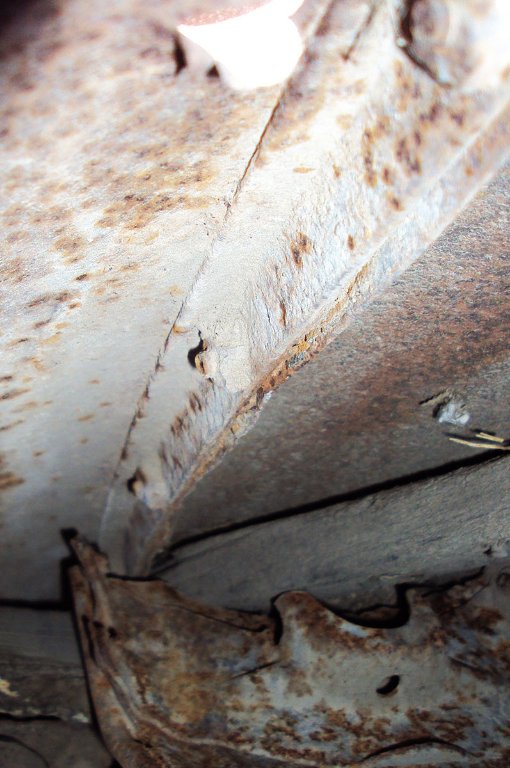

Re: Body Joining Screws 1921 Touring
These are on a later ('23 to '25) body. I hope it helps.
Thanks Richard, are both sides with the screw head toward the side of the body and are the nuts all square? Just curious as to the method of assembly, perhaps it was somewhat consistent.
I only uncovered the portion shown. I assumed both sides were the same with the small bolt head on the center panel side. If I get a chance I'll try to get pictures of the other side and the rest of it. There are several panels covering it.
The above photos are what is in my 1925.
Here are some more pictures. It is a tough place to get a camera and keep my balance so excuse the poor photography.
You can see they are the same with the small bolt head towards the center and the Square nut outside. My guess is the bolt heads are 7/16 and the nuts are 1/2 but someone who knows should verify this.
It's hard to see but it appears like they are slotted head machine screws with square nuts, correct?
No, they are hex head bolts. There are no slots.
Yes, they are hard to see in the photos. The heads are a bit rounded but are hexagonal.
