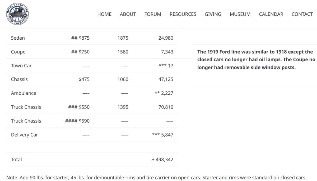

According to the encyclopedia, 1875 lbs shipping weight.

Saw this post and looking at the encyclopedia the heaviest T’s built were the 26-27 four door Sedans weighing 2004 lbs. The encyclopedia has lots of detailed T information and is interesting to read from time to time. This was another reminder.

The MTFCA encyclopedia indicates a Shipping Weight with additives for electrical components. BUT not sure if shipping weight also includes crating
https://www.mtfca.com/model_t_encyclopedia/1919/
