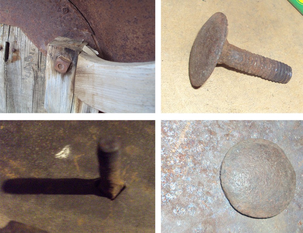

I'm surprised to see a 3/8" hole there. I have always assumed it was a "step" bolt that went there, 5/16".
This is what I believe the bolt is. It is 5/16" by 1 5/16 log. The head is 1 1/16 dia. The square hole in the hood former is 11/16". A 3/8 would be too large for it. The square shoulder on the step bolt is a bit over 5/16" so it would fit there nicely. I have drilled that hole 5/16 match drilled at assembly. 3/8" hole might have been used to give some clearance for easier assembly. Things don't always line up.
I'll see what more I can find.

One of my '15/'16 hood formers had the remains of an original bolt in it. It was rusted about half gone, the head in poor condition, the shank and threaded portion barely hanging onto half missing square nut. There was a short piece of threaded area underneath the nut that was intact enough to identify it as 5/16.
In a box of mostly model T small miscellaneous and hardware, I had two nearly identical bolts in almost good condition. A little repair work and those two I used on my runabout.
I know there is a proper name for those large head carriage type bolts? But google did not want to remind me what it is. I believe "step bolts" may be correct.

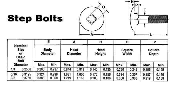

Art Bell posted this chart back in 2010. The thread also has carriage and elevator bolt charts.
http://www.mtfca.com/discus/messages/11 ... 1288281081
The step bolt dimensions are very close to the rusty one I showed earlier.
I ended up using carriage bolts in my two '15s. I soon forgot and nobody has mentioned them to me.
