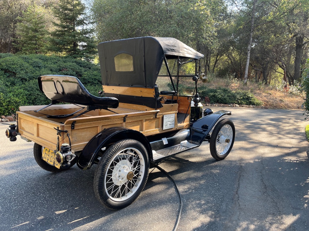

Will, post more photos of your Roadster pickup. I'm sure that I am not the only one who would like to see it.

As requested here are some pics
It was built by Vic Groah some 25 years ago
