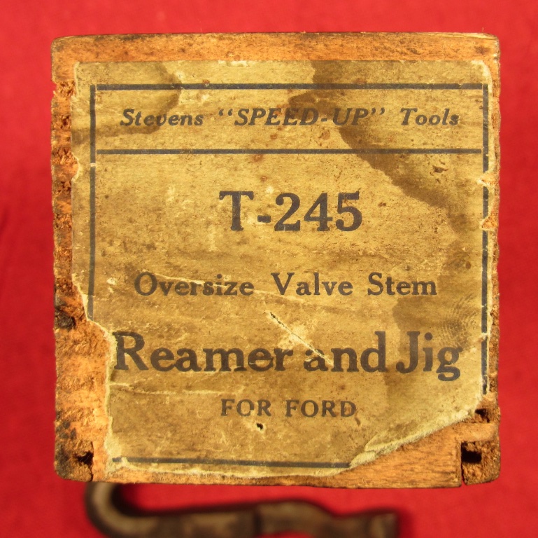

When it comes time to ream the valve guides, look for a Stevens Valve Guide reamer set up.
In order to accurately pilot the reamer through the guide, a centering guide is placed in the valve seat. When Ford machined the blocks, the valve guides and seats were machined at the same time. Stevens utilized this when they designed their valve guide reaming set up. See the attached illustrations from the Stevens catalog.

Post by Scott_Conger » Wed Jun 15, 2022 10:03 am
Tim
other than a rebuild, "in the car" is the only way I've done it, myself
my version of the Stevens Tool for Reaming:
