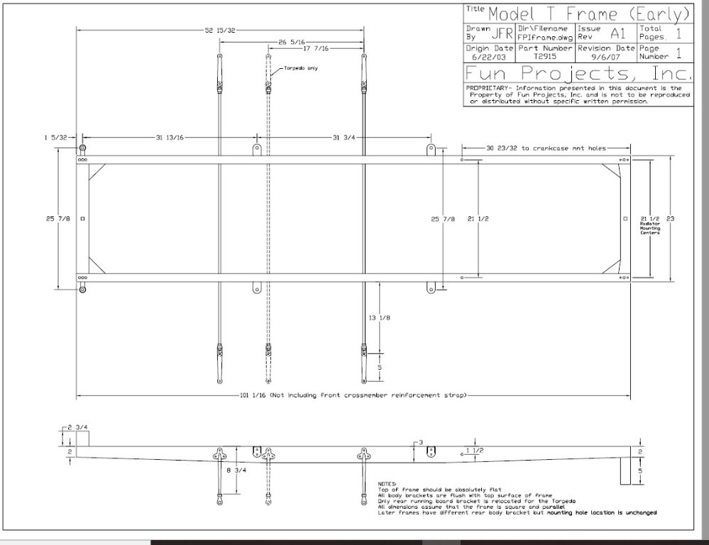

Do you mean like this   --
Did you mean like this

To be complete I think you need to measure if the frame is square. That is is the distance between the rails at the cross members correct to the drawing above and then are the diagonal measurements from cross member to cross member,as described by others, the same.
