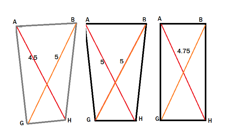

A square frame:
Education and learning are based on mistakes and repetition.
Square frame: AH = BG.
Re: Frame alignment... a suggestion.
Post by Norman Kling » Thu Aug 04, 2022 12:10 pm
That picture in the above post is not a T frame. The side rails on a T are straight.
Posts: 6590
Post by TRDxB2 » Thu Aug 04, 2022 2:46 pm
The non-model T frame is just used to show where to measure the diagonal lines. If the rails are of equal length then to square up everything (square, trapezoid, rectangle, etc you could measure the angles between the rails and cross members. However, a slight degree of difference can be multiplied at the other end of a long run. The easy way to square things up is to get the diagonal measures equal. So the example below shows an irregular trapezoid squared up and how the same applies to a rectangle (Model T)
