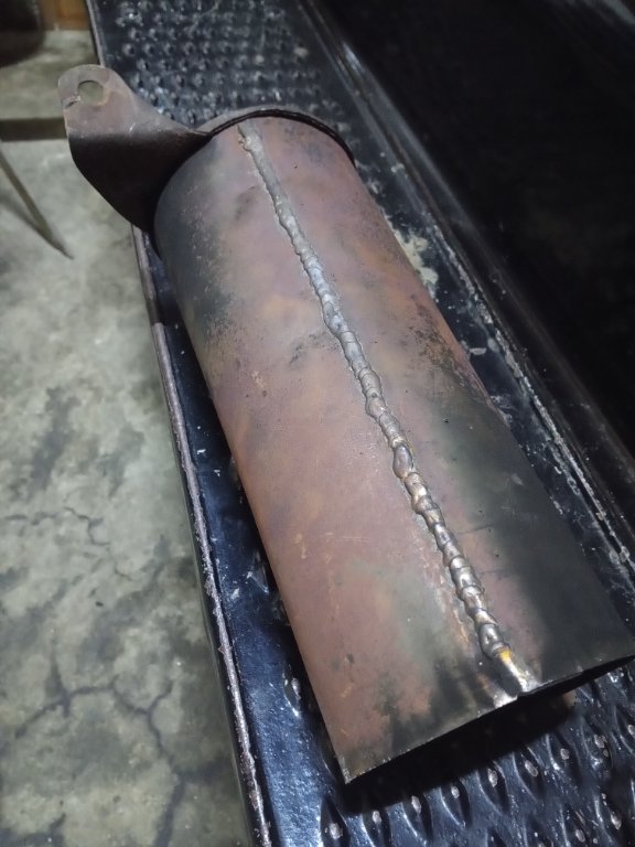

Can anybody help me further? I dismantled the muffler on my Touring 1926, which I want to get running again (original made in Canada). I discovered that the inner tube is not there. I have to make a new one. Does anyone know the dimensions of the pipe and especially the number and dimensions of the through holes?
How can you seal the outer pipe better?
thanks to all

Post by Vonau » Mon Aug 22, 2022 5:01 pm
Oh, I'm almost embarrassed by this feedback. I wasn't even aware of this rarity. I'm fairly new to the Model T scene.
I had to do some tweaking on the screw. I hope this will be closed.
The outer tube was rebuilt and is not very professional. I think I'll leave it with the weld seam facing up.
I am amazed by the double-layered muffler ends.....
Creating a suitable inner tube is not a problem. But I have no idea about the drilling.

If you calculate the area of the "window" openings in the exhaust pipe and double it for the total area of the holes in the inner tube, you should be close enough and the muffler should sound close to original. I don't know if the holes ought to be drilled in a regular pattern or clustered toward one end or the other of the inner baffle.

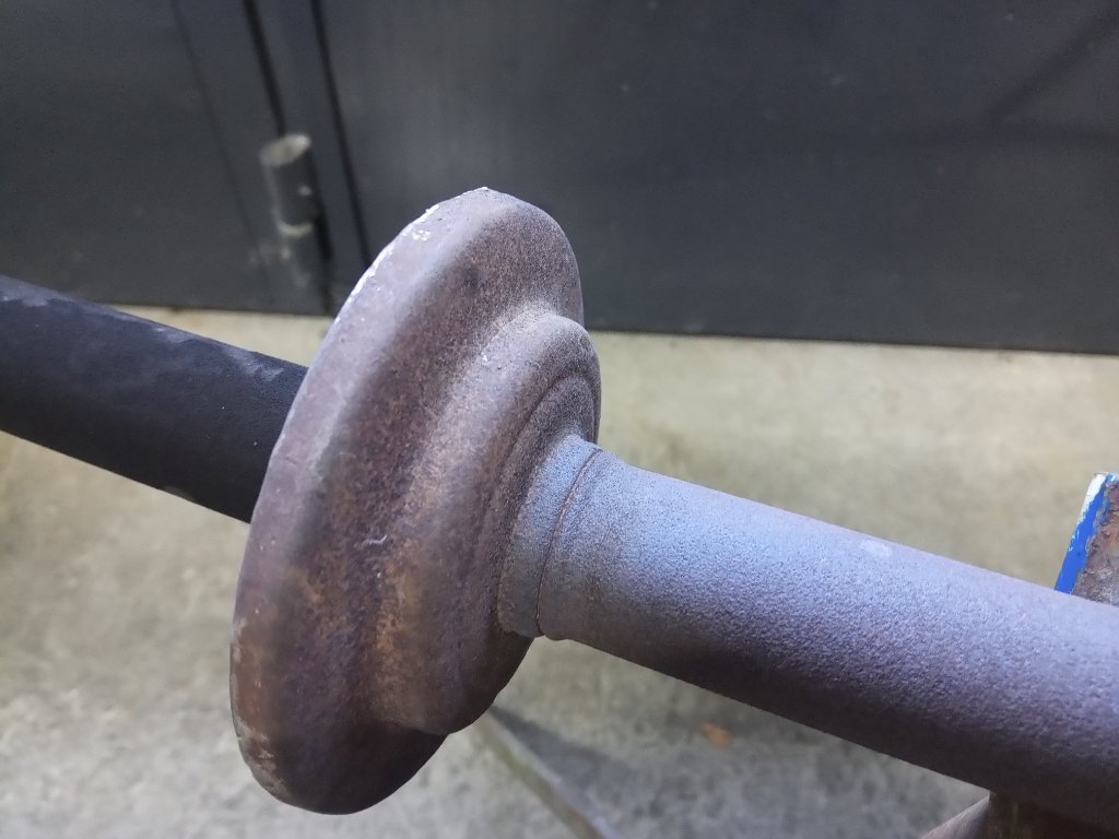

I disassembled my muffler. My pipe has the ring formed on the pipe at the front of the muffler. I cannot exactly verify the date of manufacture. Les

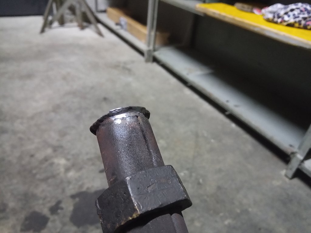

Re the square holes at the rear end of the pipe. I suggest those holes were punched while the pipe was straight. Come bending time, it mattered not whether the holes were on the side or top.The straight blank would have fitted the mandrel as it was picked up by the worker. I could be wrong.

Have only one original pipe with the front plate, but it was missing the rear plate, and the shells. Guess I thought too these had a middle shell, just not the tail pipe and outer shell.

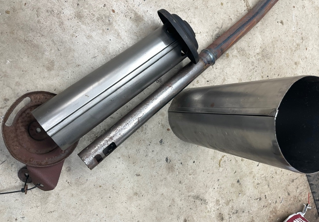

Trying to fit a new set of repro. muffler shells to your pipe.
The inner shell is 3” x 13” like Les pictured. But the thick fold seam keeps it just bit too big in O.D.
Same with the outer shell, just too big in dia. for a nice fit to the original end plates. May have to revert to fab up new outer or beat some more on the shell rim edges :(
Posts: 4084
Re: 1926 muffler not complete
Post by DanTreace » Sat Aug 27, 2022 2:20 pm
Success ;)
After some more shaping with the ball pein both ends snugged together with the middle tube in place like original.
Now to find that bolt and locking plate to fit muffler to Larry’s repro tail pipe.

If the big dished washer is correctly used against the rear muffler end, it will eliminate it getting squished like the photo above. I have used late front end stabilizer washers for this purpose, then the lock washer and hex nut. Works for me.

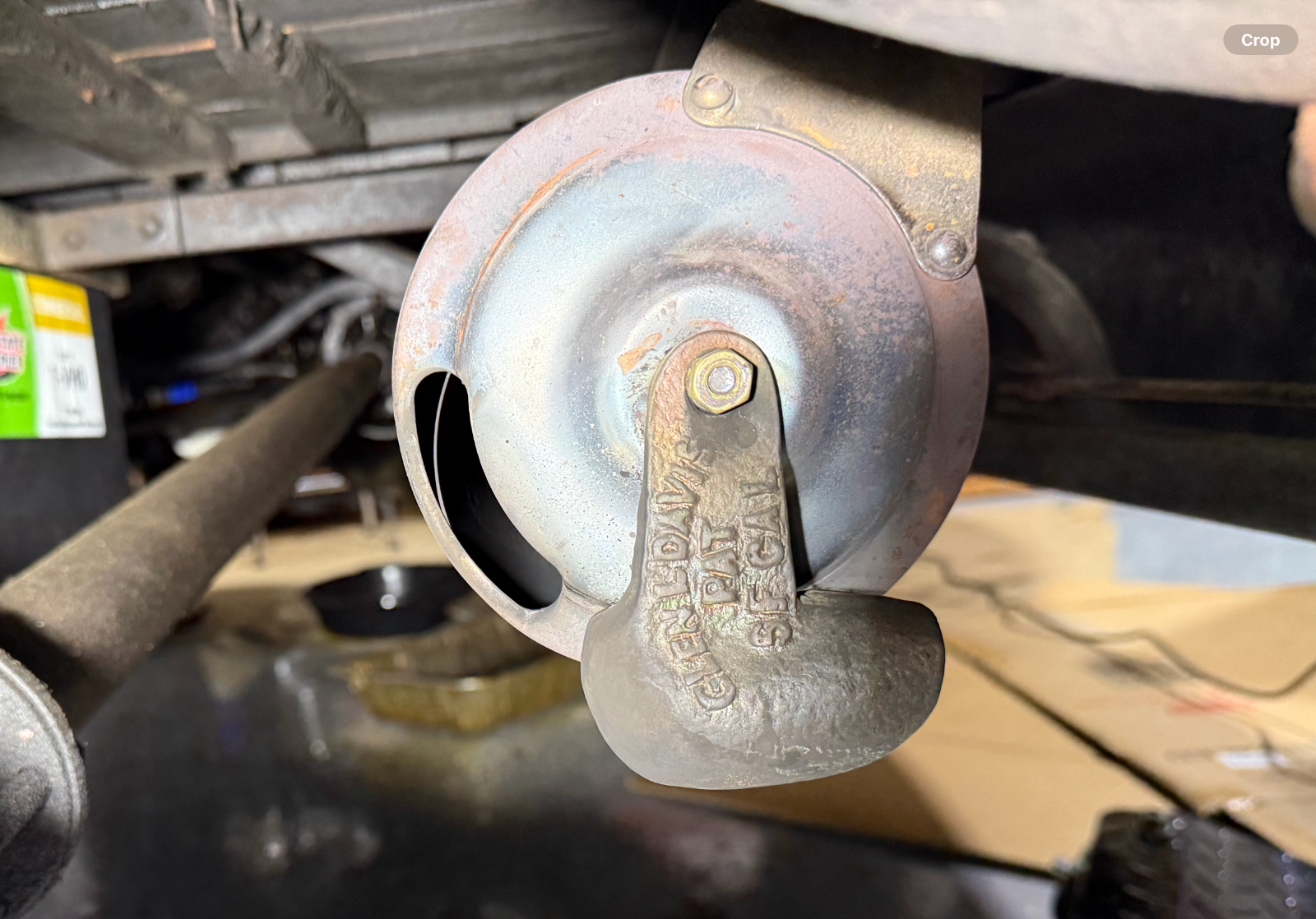

I have a 26 touring that has a very similar muffler. There is an extra piece that does not seem to be in the pics above, anyone know what this is? It rotates. When should I rotate it?

mireland wrote:
Sat Jan 11, 2025 10:50 pm
Matt,
That's an accessory piece. It's an exhaust deflector and should be rotated until it covers the exhaust port on your muffler. It keeps the sooty exhaust off of your rear axle housing. Its weight will probably cause it to swing back down to the 6 o'clock position, however.
