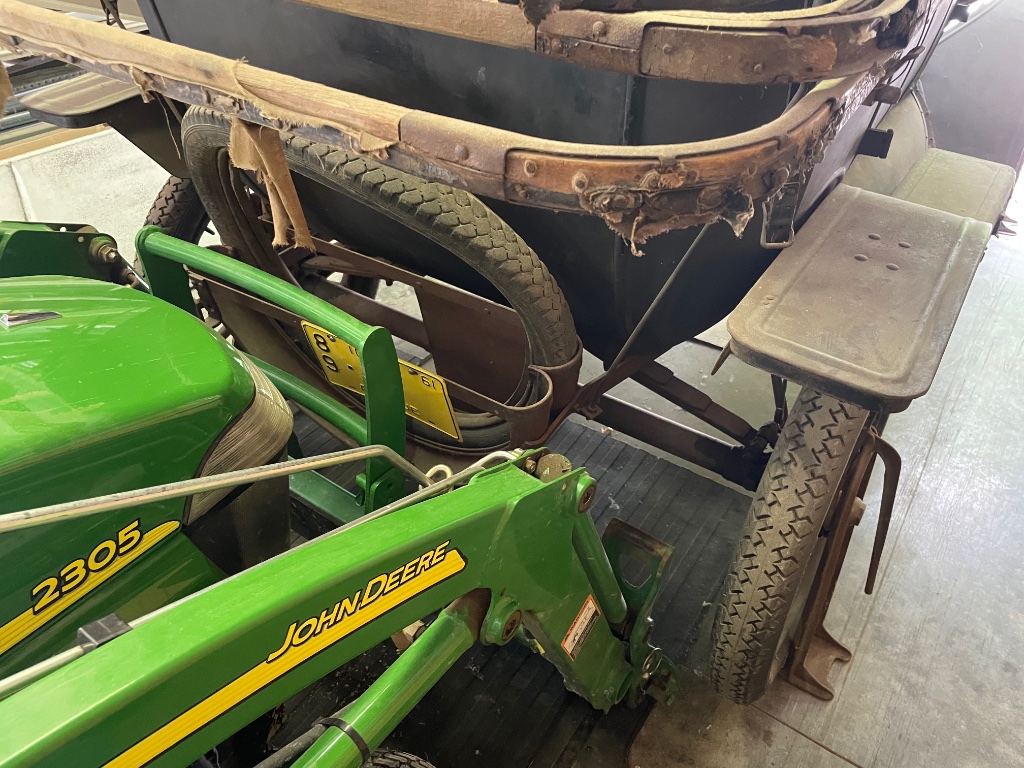

Brought this double spare tire carrier yesterday for $40 for my 1914 touring. Assuming that it is correct because it has a narrower spot for the 3" and wider for 3.5" spare. Are there any brackets I'm missing? On my survivor car, you can see where one used to be attached to the top side of the drivers false door. I'm sure it was a different brand from this one.

Think I will mount the carrier on the running board since you don't exit the car on the drivers side anyway. If you mount spares in the rear you make the car longer. Might make a difference between hauling 2 T's versus 1 in my enclosed trailer because I DIDN'T make the car longer. However I could concede that a spare at the back might protect the car's body if you bumped something

Steve K, your particular spare tire bracket was probably intended to be mounted on the running board. Although bolting the sides directly through the rear body might have also been done. Many rear mount spare tire brackets had metal to extend under the rear tub as part of the bracket mount.
You might be able to mount yours far enough forward between the running board and front fender and not need to move the carbide/acetylene generator. Give it a trial fit and see?

Here is my 14. I actually have the prestolite tank to deal with rather than the generator to make room for the tire carrier. It is a problem too.
