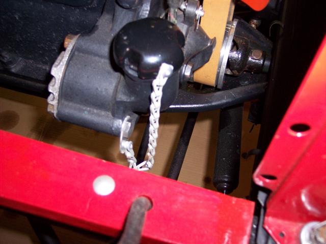

Where did you park for lunch ? If it was a twist fit, chances are it didn't walk off on it's own. Our '14 Touring had the original brass cap modified by soldering a 3/8" brass flat washer to some brass chain which in turn was placed over the timer clamp bolt and the other end soldered on the top edge of the cap.

- Posts: 5471
Re: Lost cap
I know Tim - hate to think the worse but sh_ _ happens !
That's very much like what was on ours.
