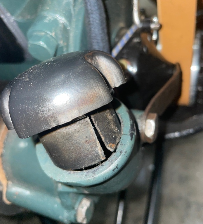

Re: Lost cap
Post by ThreePedalTapDancer » Mon Oct 03, 2022 9:40 pm

The "tube" part that goes into the timing cover is a bent round piece of sheet metal.
I spread the seam a bit @ the bottom to create a sort of spring tension. Squeeze the base a bit to install.
The cap is tight in the cover.
Posts: 4041
Re: Lost cap
Post by DanTreace » Wed Oct 05, 2022 12:57 pm
After that collar is round for tension, then bend a ‘tooth’ on the edge with the needle nose. That tab will grip the front plate hole and secure the cap for the roughest roads!

The bent tab or moving one side over just a bit works for me. I can’t just lift my caps out. There is definitely tension on them. Ford didn’t use anything to hold them down that I know of but not 100% sure.

I solder a chain to the INSIDE of the cap, and wrap it around the bolt.
