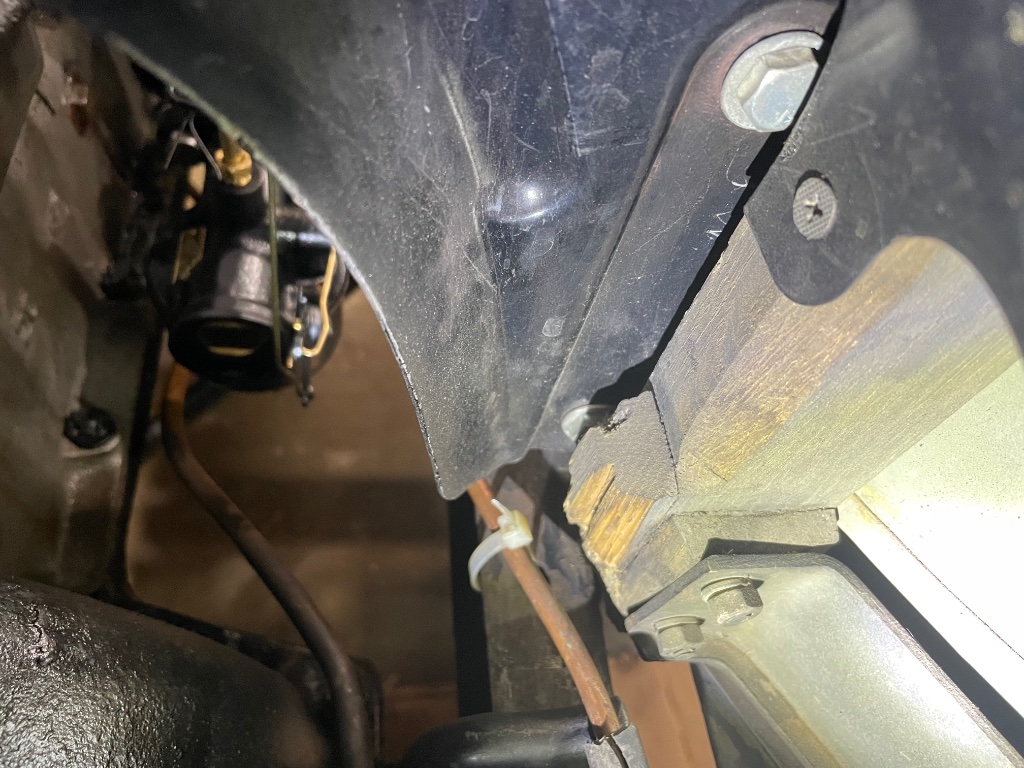

I am still trying to figure out the body placement issue that is causing the hood to be a tight fit on my 22 RPU. I found that I have the wrong frame to firewall brackets for my metal firewall. I think this is contributing to the issue. I want to fully understand the issue before I do anything. Today I crawled under the car and took out some of the bolts attaching the body to the frame. The holes are round and there is not enough room to move the body to the rear the 3/8-1/2 I need.
It looks like there has been some wood replaced in the body, including the lower rails where the steel body mounts are bolted. I wonder if the mounts were installed in the wrong location (based on the wrong frame to firewall brackets) when this wood was replaced. Not sure how to check/confirm this.
I could reposition the brackets by plugging and re-drilling the holes in the rails or slotting them to get ovals which would allow me to move the body. This would work fine for the front bracket. But could be an issue with the mounts on the rear cross member, which is also the fender mount as those bolts go through the body panel.
Any thoughts would be appreciated.

So I got home from work, took the floor boards out, and found what looks like a block added to the wood frame to move the frame mount back and the body forward about half an inch (see the picture). This does not look right. It amazes me the length folks will go to do something wrong.
- Posts: 6523
Re: Body position issues
Well, you've just answered the question as to why the body is crowding the hood
Now you're in a bit of a pickle regarding at least the forward brackets as the carriage bolts which mount it to the main sill are covered over by body skin. As you have cyphered out by now, that bracket must go "forward" in order to pull the body "backward" (as well as the other mounts as well).
I personally would pull the 3 nuts holding it to the main rail, remove the forward blocks that do not belong there and weld the carriage bolt holes closed and redrill them over the necessary 1/2" or so to pull the body back. Or conversely weld the mount hole closed in the bracket and redrill (I am suggesting this without having looked at my runabout, so don't know which I'd personally chose right now).

With a sharp chisel and some patience I can get the blocks off without removing the bolts. Then I will move the brackets to where they should be. It’s easy to plug and re-drill the holes in the wood.

The rear fender brace is the problem. The best thing to do would be to leave the bracket in the correct place, unbolt the fender brace, slide the body to the correct position, re drill the holes for the bolts holding the fender bracket and reinstall them. This will lead to an extra visible hole in the side of the body. I could replace the sheet metal so the hole is not visible.
I think modifying the brackets is the way to go for now. But it has gotten me thinking about how one would get the sheet metal off the wood. I have not been able to find any detailed information on how the sheet metal is attached in the books I have or on line.

If you take a 2nd look at his picture, you will see a 1/2" thick block which does NOT belong there, which thrusts the body forward in the previous owner's mistaken belief that he had to do that to accomodate a steel firewall with the wrong firewall brackets. This is the entireity of his hood fit problem. So, yes, that block needs to go, and the body must be shifted rearward where it belongs.
This is what the area SHOULD look like...i.e. no extra block between the body bracket and cowl riser:
he is not dealing with a rod that comes through the body
it being an ex-runabout, the fender iron is attached to the sill. Regardless of where the body presently sits (1/2" too far forward). The fender iron is located to the frame and not the body. Moving the body back to where it belongs will shift those fender iron holes backwards 1/2".

My buddy Tim came by after work and we shifted the body to the correct position. I have some body bracket modification ahead, but things look/fit a lot better already. I will put some pictures up when it’s done.

FWIW - I suspect your car may actually be a '23 as I think but am not certain, that your front metal body mounts for the sill were "new" in '23 and earlier than that, the sills were built quite different at the front. Not that it matters one bit...
