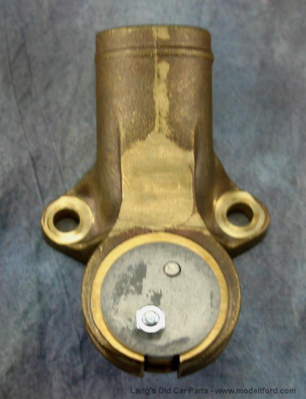

Jab35, You're right, those are really great pictures, but I still have a question or two...the plate on the eccentric has two holes, one is obviously for the fan shaft and the other is for a locating pin to keep the plate from moving catty-wham-pus when you adjust the belt tension. From these pictures it is plain that the locating pin is in the eccentric part, but how about on the 26? It has a "quarter moon" shape cavity and not the "dog bone" shaped one of the 27 and that hole is in the moon cavity, but there is no pin, so my question is, on the 26 was a bolt used instead of a press fit pin for or is there a pin that presses into it?
This is an early 26 fan bracket and eccentric part, notice the hole in the "quarter moon" shaped cavity that is for the locating pin? Since the hole is quite a bit larger than the one on the place I'm assuming that, that hole is probably threaded and has a reduced shank for the pin hole on the plate.
This is the picture that Dan Treace posted in 2015, also note the pin sticking out of the eccentric part. I'm assuming from the size of the material around it that it is pressed in, but I'm not sure.
On the new replacement bracket/water outlet you can also see a pin sticking through the plate, the bolt below is to keep it assembled (probably for the pictures).
If there is a separate pin, does anybody know its part number and or dimensions?

Martynn: I saw a pic of the early improved mount that showed the cast iron disc that supports the axle. The circumference of that cast iron disc was cut like a worm drive wheel. Turning the bolt engaged the teeth and rotated the eccentric disc to tighten the belt. Tightening the nut of the bolt locked the disc to the holder. I'll look for that pic, seemed rather complicated for so simple a function, much too complicated and too frail for Ford. jb

Post by VowellArt » Sun Apr 28, 2019 7:53 pm
You mean like this one?
George Clipner's car is an early 26, and has this eccentric part on it. The large bolt below is what engages with the threaded knurl and turns it to make the adjustment...but to lock it in place you still have to clamp the eccentric part and the plate against the bracket.

Martynn
There is no part# for that stub (pin) on the #3987B Eccentric, the stub is part of the casting. That stub fits to the Eccentric plate,#3988.

Looking at this picture, there doesn't seem to be an eccentric plate on the pulley side of this assembly...was there one supposed to be there or isn't there one on the early 26's?
I don't see how adjusting the nut on the back of the fan shaft does anything, since there is no flange on the eccentric part nor is there any evidence of an eccentric plate either. Which would indicate that the adjustment worm screw, nut was used to clamp onto that part. So this assembly doesn't have that plate then, does it?

Martynn: The above picture of the assembly is the same as illustration in the Ford book. No flange on the eccentric and no plate on the fan side. The nut secures the fan axle to the eccentric. The locking bolt on the clamp keeps the eccentric axially centered in the clamp and rotates the eccentric to tighten the belt. The nut on the locking bolt clamps the eccentric inside the bracket. jb

James has the very correct information on the assembly.
All that could be added, is the end of the fan shaft has two flats for holding that shaft in place with a wrench when tightening the hex nut with another wrench. Since the large flat head of the fan shaft is hidden within the fan pulley housing, you can't grasp that. So the end of the threaded fan shaft is held in position when tightening the nut, to maintain the correct tension of the fan pulley against the felt seal and cap at the back of the pulley.
