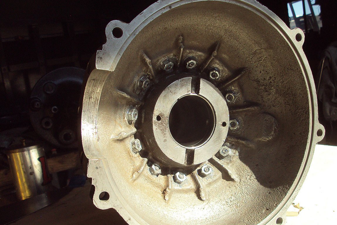

I'd pull it apart too, and have the pieces hot tanked to remove all grease and crud. I put mine back together with nuts and bolts. The bolt heads are turned to look like rivet heads. The inside end is slotted to take a screwdriver to hold the bolt as it is tightened. Two Loktite products are needed. Red 515 non hardening flange sealant around the inner end of the centre castings and around the flanges through which the bolts are fitted. Nut loc is used on the nuts, and if you are worried, the ends of the slotted bolts can be bent out to act as a locker. Because the sealant does not set, movement/shocks to the axle assembly will not open it up to possible leaks. It also stays flexible around the bolts.

I restored my ‘14 rear axle housings just like Allan. I might add that I used #8 bolts and nuts.

Brazing might be the best solution, but I used JB Weld and made screws with rivet heads to joint it. I painted it liberally to add to the sealing. One has sealed well for 20 years and the other for 8.

Hi Rich, I like your solution. what did you do with the nuts of the rivet to be sure they will not move or fall down inside the rear ? Thank you SirRich Eagle wrote: ↑Wed Dec 07, 2022 3:08 pmBrazing might be the best solution, but I used JB Weld and made screws with rivet heads to joint it. I painted it liberally to add to the sealing. One has sealed well for 20 years and the other for 8.

I seriously staked and peened the nuts. It is a good question.
