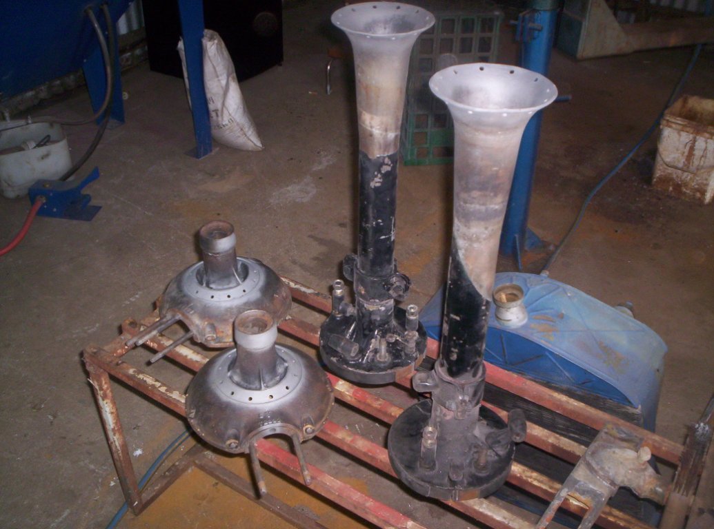

Following this thread was interesting about repairing the 1914 rear end leaks so I thought I would contribute with this one that ended its days as a jack stand! It’s been used around the shop for years. I guess after the original owner had stopped the leaks with brass he found one last use for it! It was a fairly good brazing job I guess.
