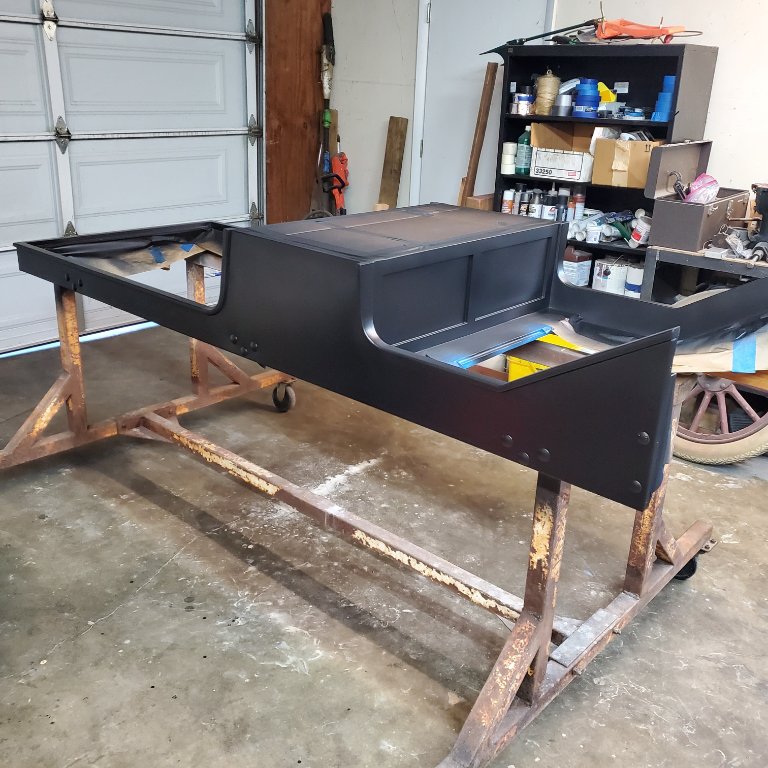

My suggestion has to do with filling the grain on a wood body, some pieces of which were oak. I tried various products including a wood primer, wood fillers, a sanding sealer and other products Im too embarrassed to list!. I found the best result came from using Dap premium wood filler watered down as suggested, followed by sanding smooth. Usually one pass was all that was needed. But a few places required a second application. It really works well.
I followed by spraying a watered down wood primer and then a coat of DP90 before delivering it to a pro for finishing.
