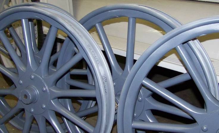

Wood spokes sealed with Zinsser brand bare wood primer. Nason gray primer used as final was a light gray for early 1909's. You may want to use a black primer for a very dark finish coat.
Final finish Dove gray Nason acrylic enamel w/ gloss hardener.
