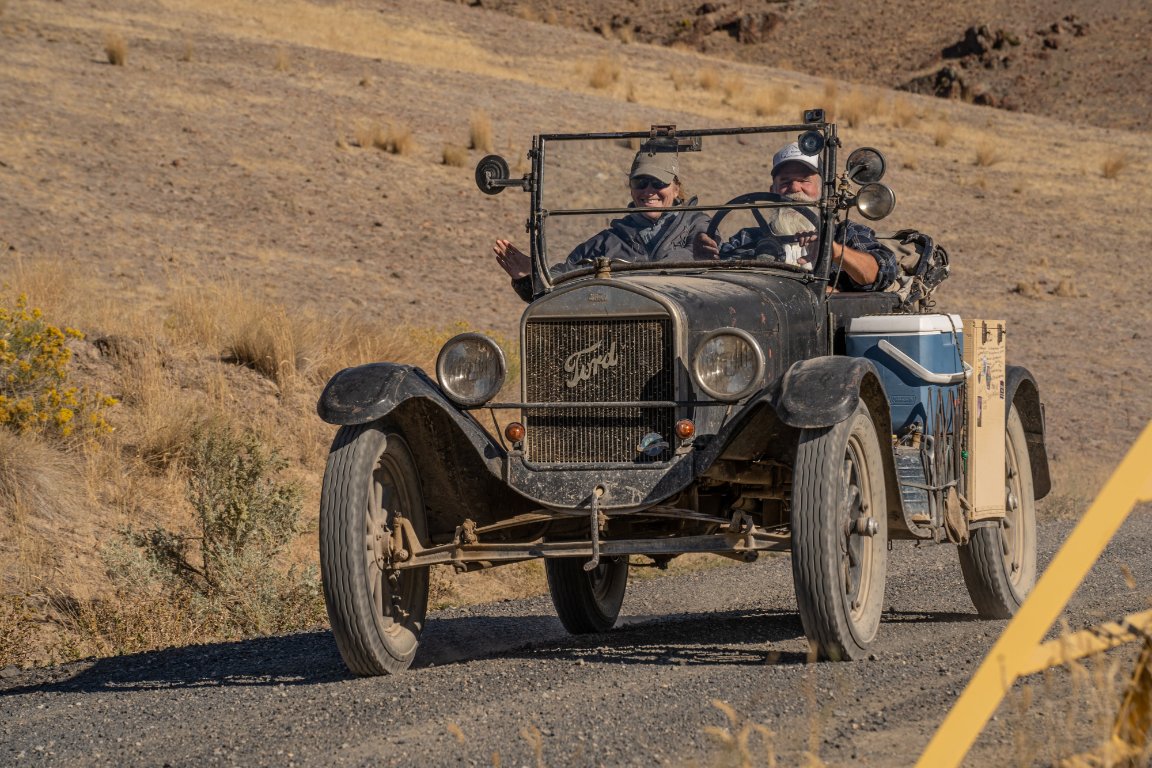

I used old glass clearance lights bolted to the radiator mount bolts for the front and Model A tail lights with the lower light used for the tail light and turn signal and the upper light for the stop light with stop script out of a Model A drum tail light.

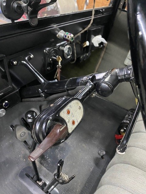

Do you have bumpers? Attached are two period 6V turn signal lights that are currently selling on eBay. They can be found by doing a search with “vintage 6V turn signal lights”. Jim Patrick.

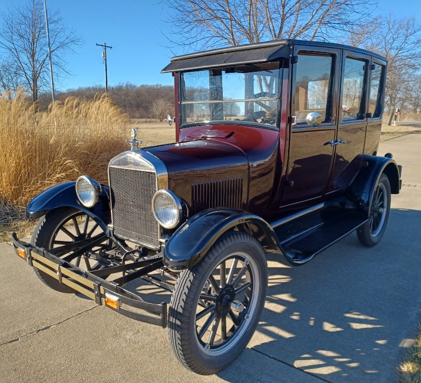

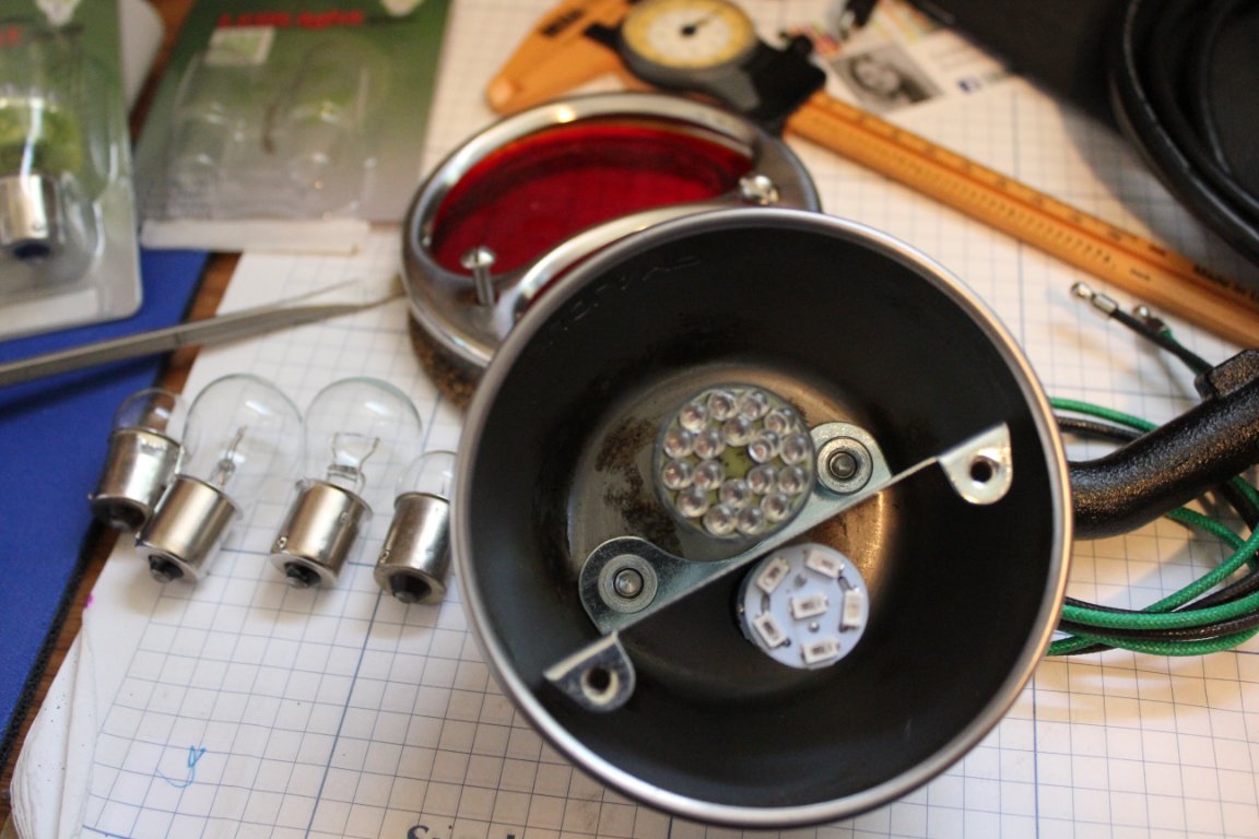

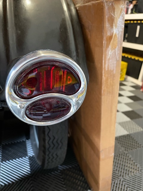

For the fronts, I bought standard BEEHIVE and converted to LED. Find a 'wire rope clip' of the right size to catch the mounting of the BEEHIVE and still go around the front fender iron about 1/2 way up...works...(I'm the loon that went and changed to cloth covered wire that was pulled through woven tarred loom, and homerun to a new terminal block mounted inboard on the sills)
For the backs, I went with the Model A dual bowl teacup repros (went with stainless ring bezels-why not?)...went with Model A mounting irons for a Hack (mounted them to the bottom sills), then even bought the little flared A steel pieces to cover the connector up nice and tight). (Same loonie thang...I changed out the wire to cloth covered, pulled through tarred loom, homerun to same hidden terminal strip on sill--- but this one left as miniature lamps---fit problem with LED AND I was having issue with a dropping resistor needed with LED for all around so went incandescent).

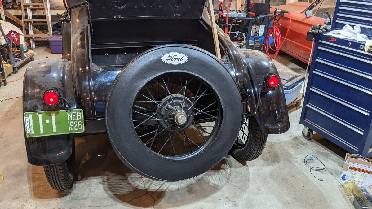

I bought a second taillight for my '26 Runabout. I cut off the part that holds a license plate and mounted it on the right fender. (Don't hold cutting up a T part against me. It was a rusted, welded piece of junk.) I bought a right-side mount and backing plate from one of the vendors. I also put 2-prong sockets (from Snyders) in my two taillights and now I have brake lights and turn signals. My front turn signals look like George's. I will find some photos and add them here.

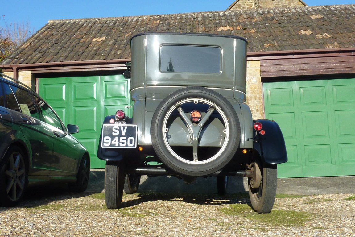

Motorcycle lights supplied on rubber stalks, underneath

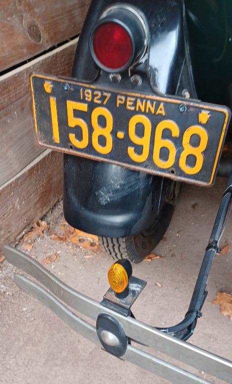

- * REQUIRED* Type and Year of Model Ts owned: 1927 Fordor
- Location: Glenside, PA
Re: 1926 Coupe - Rear Directional 6V
I second the motorcycle blinkers, small enough for an easy install and look great!
George - the rear chrome teacups - was also looking at those last night but the Model A's are 12V. My car is 6V with no intention currently to change to 12V.......Are your rear chrome somehow 6V?

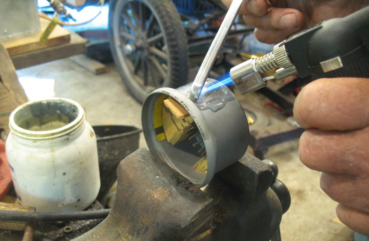

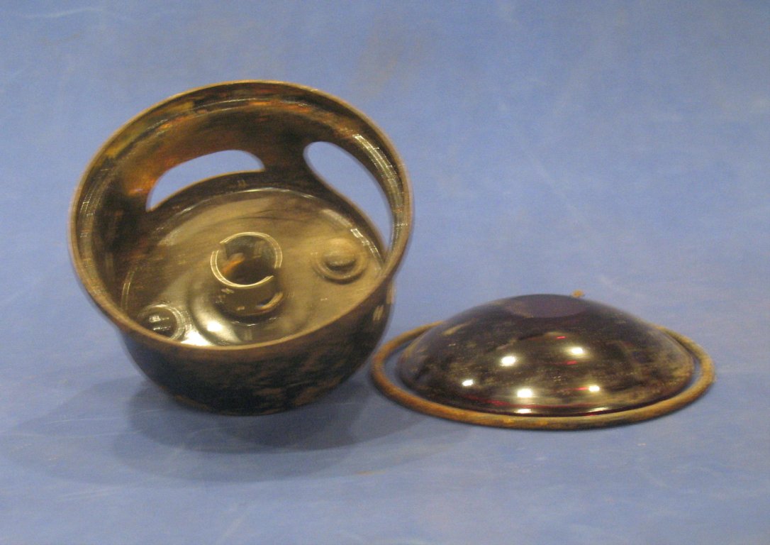

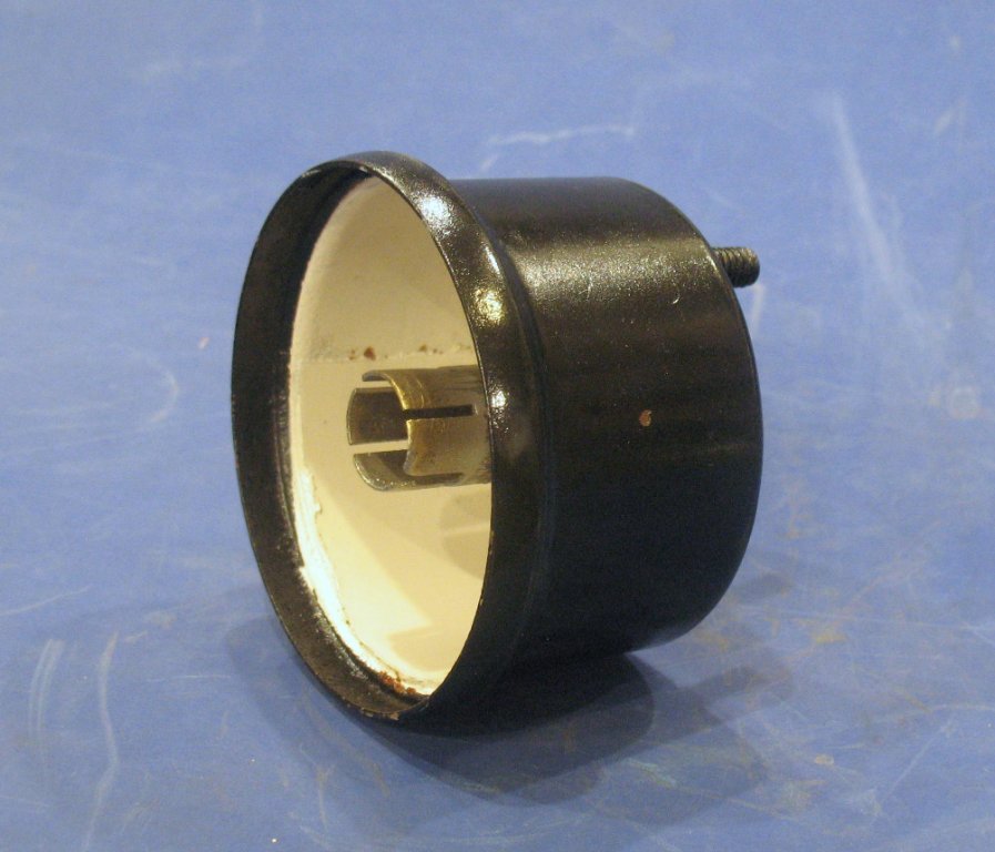

My 1915 had no electric lights other than the magneto headlamps.
For tail/brake lights I used a pair of twenties stock Ford tail lights picked up at Hershey.
Combining bits of paint can with body solder, I removed the openings for license plate lights.
I wiped the road dust off the lights for a picture. The tail/brake lights have 1157 equivalent LED's. I went with 12 volts because they're readily available and likely to remain so. The rear turn signals are beehive lights also from Hershey. Magnetic trailer lights on the fenders were an abject failure, so I made removable stalks that fasten to the bottom of the body with wing nuts.

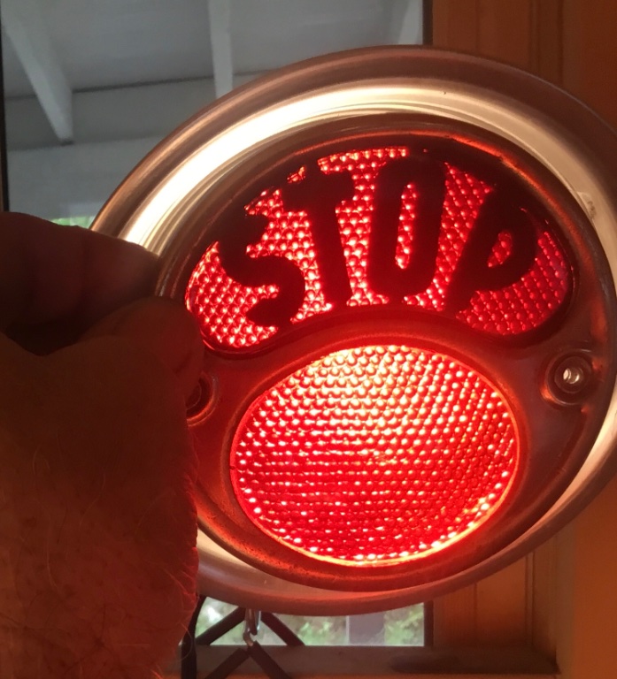

I am particularly fond of the 28 A tuna can tail lights.
They mount directly to the 26-7 stands.
They look similar to the period optional accessory Ford tail light with the stop script inside.
I personally think they are better proportioned visually, not to mention way cheaper than the original accessory light & readily available as re-pops.

This is what I did on our 1922 coupe.
In the first photo:
I bought a old universal add on directional stalk off of Ebay and made an adapter out of aluminum round stock so it would clamp onto the diamond cross section steering column.
In the second photo, I bought reproduction '37 Ford LED brake/tail lights, and made the mounting stalks out of 1/2 steel round stock (by heating it up and bending it around a 8 inch steel pipe) with flat bar welded on the ends for mounting, to fake an "original" appearance.
In the third photo, I found a set of a arrow directionals, installed LED boards in them, and made the mounting stalks out of 1/2 steel round stock with flat bar welded on the ends for mounting them.
The non model T observer of the car thinks they are "original" since they sorta look like they belong on there, and are obviously not plastic truck/trailer clearance lights.

I did a bit of looking. Brattons A & Snyders list them in Left & right. Unfortunately both are out of stock for the lefts. Available in nickel or black. If one didnt want to wait, a left could be made from a right. The clear lense, gasket & clips are available. Dont forget the 2 stop stencils. Not clear if they are included. Around $130 each.lirogo27 wrote: ↑Fri Feb 24, 2023 7:50 pmJohn, You are close by! I attend the LB Club. Any indication of where I could scrounge up the tuna cans? (DOn't say the supermarket!!!!!)speedytinc wrote: ↑Fri Feb 24, 2023 3:51 pmI am particularly fond of the 28 A tuna can tail lights.
Original pass. cars were plated brass. Typically cracked.
I was really lucky to find a pair of commercial units. (steel cans) Painted them black.
One of the OC members pet a set of nickeled on his restored coupe. Really sharp!

Mine are mounted with no drilling required, it is a separate bracket mounted to the bumper bracket. Here's some photos of the rear.lirogo27 wrote: ↑Thu Feb 23, 2023 9:15 pmJeff,greasemonkey100 wrote: ↑Thu Feb 23, 2023 6:38 pmI second the motorcycle blinkers, small enough for an easy install and look great!
Thank you! Let me look into them. I don't want to mount to the fenders. I want to do as little damage to any part of the car in trying to mount them. It doesn't look like there is a work around for avoiding that!!! Nice car by the way! LOVE IT!

Jeff. OK....Those are also great. I like the small shape and how they attach with no eyesore. You all have some GREAT GREAT suggestions. Let me also look into the motorcycle blinkers . Where specifically did you buy yours.......and are they 6V as mine is a 6v car. I do see something similar light wise on eBay.greasemonkey100 wrote: ↑Sat Feb 25, 2023 3:27 pmMine are mounted with no drilling required, it is a separate bracket mounted to the bumper bracket. Here's some photos of the rear.lirogo27 wrote: ↑Thu Feb 23, 2023 9:15 pmJeff,greasemonkey100 wrote: ↑Thu Feb 23, 2023 6:38 pmI second the motorcycle blinkers, small enough for an easy install and look great!

On my 1925 coupe, I used the Model A teacup style tail lights and fitted them with 6-volt LEDs (photo 2). For mounting the lights, I used the cast brackets for Model A Panel Deliveries, Pickups, and most AA Truck chassis (according to the Snyder's catalog). The bracket is Snyder's part A-13470, $18.95 each. I also used a piece of angle iron and (horrors) drilled into the spare tire carrier to mount the angle then the A-13470 bracket was bolted to the angle (bottom photo). Other than the looks of the non-authentic wiring which mostly doesn't show, I'm happy with the result.
Jahn
1925 Coupe--owned by my Grandfather
- Posts: 5269
Aware they are upside down?
jiminbartow
- Posts: 2485
- Last Name: Patrick
- Location: Bartow, FL
Yes. Metal STOP insert should be on top.
Jahn_Wright
- Posts: 26
- Joined: Mon Jan 07, 2019 11:39 am
- First Name: Jahn
- Last Name: Wright
- Location: Rio Rancho, NM
Wasn't aware they are upside down, but they didn't come with a STOP logo so doesn't make much difference--they light just fine.
Jahn
- Posts: 5269
There are metal stencils available new.
I think they only came in the tuna cans, but they look neat.
They came in the 25-27 accessory tail lights from Ford & the other users like dodge.
