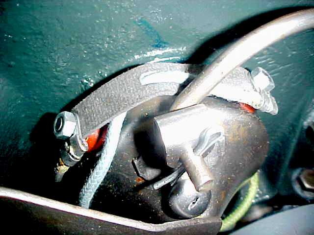

Commutator wire retainers are shown in Lang's catalog (5033B) page 77. Should I use these? They hold the wires, but what are they attached to?

They just fit under the nuts that retain the wires. They were on my unrestored '22 Centerdoor so I guess Henry thought they were a good idea but since they fell apart when I replaced the wiring harness and I didn't replace them I guess they are not necessary. I don't have them on any of my other cars either.

Factory #2124A Commutator Wire Terminal Retainer introduced in 1921 and two are required. This part addresses a common problem with Timer to coilbox wiring (near the Timer) chafing and shorting to adjacent bare metal and also forms the wire routing and relieves the strain on the wires to the timer terminals which break from constantly moving when the timer case rotates.
If you don't use them you risk the possibility to develop a short to ground in the timer wiring because these are not installed the coil will exceed its duty cycle and cause the problem shown in the attached photo. When the tar boils out the top of the counterbore on the wooden coil top it also jams the points closed exacerbating the heating process. Don't use them at your peril.

The 1928 parts book shows them for 1921 to 1927. I have yet to see one in the wild! lol
Maybe back in the day when these cars were being driven every day, chafing on the wire behind the timing rod might have been an issue, not so much today.

I dont run roller timers. If I did, I would use this insulator part. Why not?
Henry deemed it necessary enough to bear the cost(must be necessary. Remember cutting bits of a penny per car was an art form)
& its cheap insurance against shorting.

I'm sure these wire retainers properly installed can be used on all timers.... I made my own retainers out of an old leather belt.
