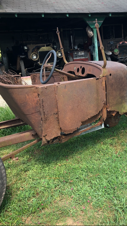

I had a T chassis that I used the motor from for another car then I picked up what was left of an Overland touring car for $100, which was the front half of the body, frame and radiator shell. I got a motor at Chickasha a few years ago but I’m getting closer to finishing.
I know now that a Ford gauge will work. I used the Overland front end and steering box so I think I’ll use the Overland column. I had shortened and fitted a Ford column (not the one in the picture) but I think I’ll use the original one since I’ve got a couple T columns to look at already while driving. As long as I can make the spark and gas rods work from the Overland column to the T motor.

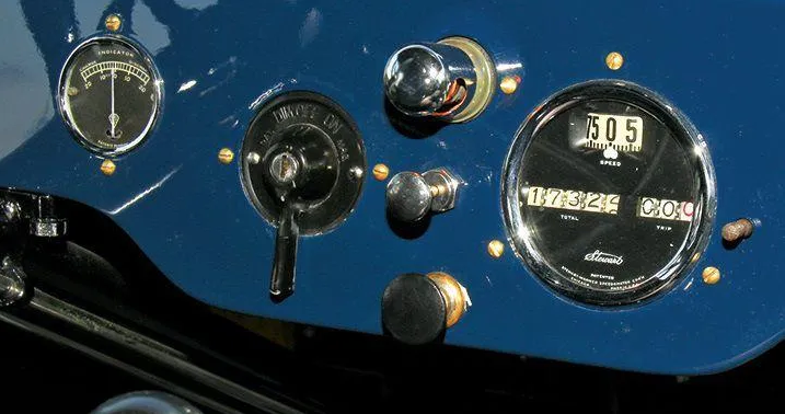

Corey, that bottom black switch takes a larger key that looks like the Model T key with grooves on both sides and is very difficult and expensive to find or buy.
They were used on a few more expensive vehicles, seems like Dodge was one.

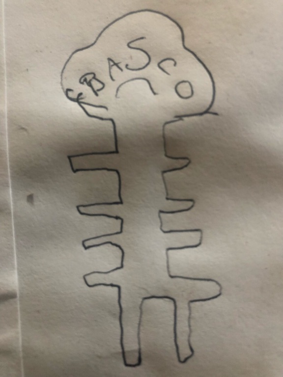

I had a switch like it once before that had a key that looked like my crude drawing. It was a Briggs and Stratton key. I don’t know if it was correct but it worked. I bought the switch and then found the key in a basket of keys at a flea market, then I sold them and and am starting over but before I was working on an Overland but this time I’ve got to make a switch that switches from mag to battery.

The Dodge Brothers Clum Key for sale in the classified parts is the type that the lower black ignition switch needs.
The DB on the key is for dodge Brothers.
The key has a number and the switch cylinder should have a number, like the Model T keys.
