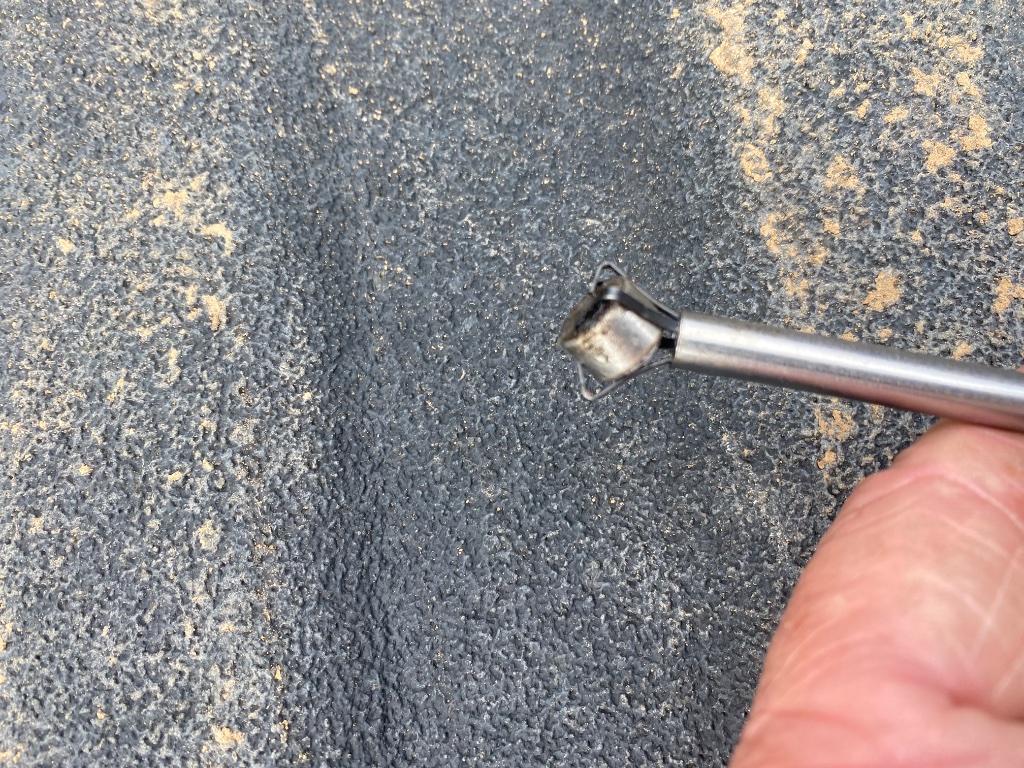

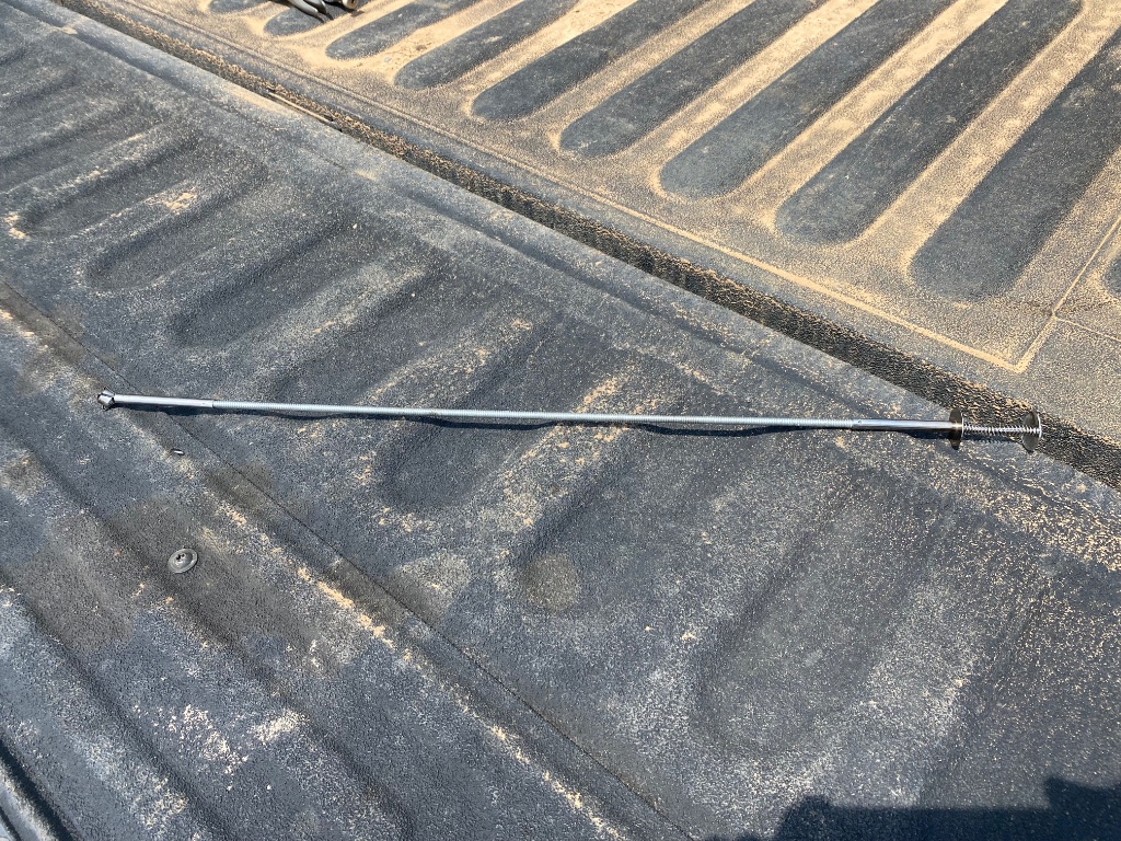

I thought I would share this tool that I came up with…. perhaps it’s been done I don’t know.
So, in spite of all the dire warnings about not dropping things down the Hogshead during removal…. and trying to be extremely careful…..
You guessed it, a washer slipped out of my hand, much to my and chagrin… down slope, and under the fly wheel and magneto….Purchased a 24” flexible, mechanical pick up tool… put a small round, magnet in the fingers….and done first pass…. it hugs the bottom wall of the hogs head if you push it down from the side…. I heard the washer click onto the magnet, and felt it also before I had pulled the cable back up and a side to side motion in about 4 inches of travel.
Life is good!
							Hogsheads retrieval toll for the simple minded!
