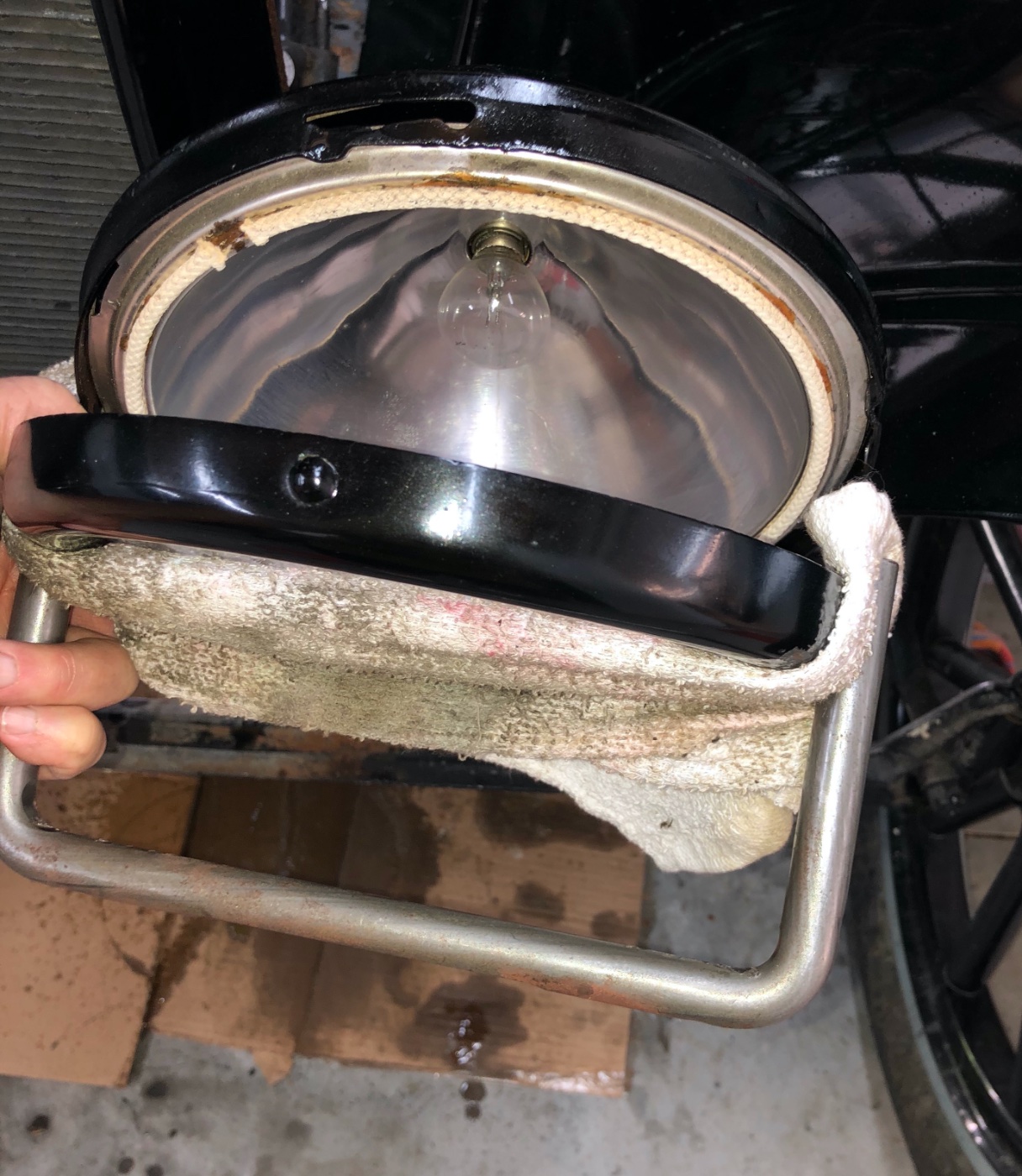

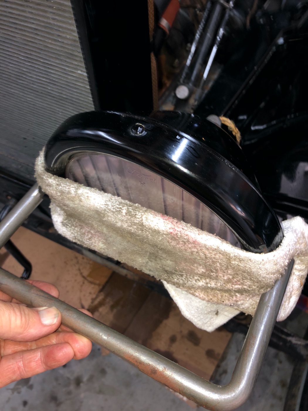

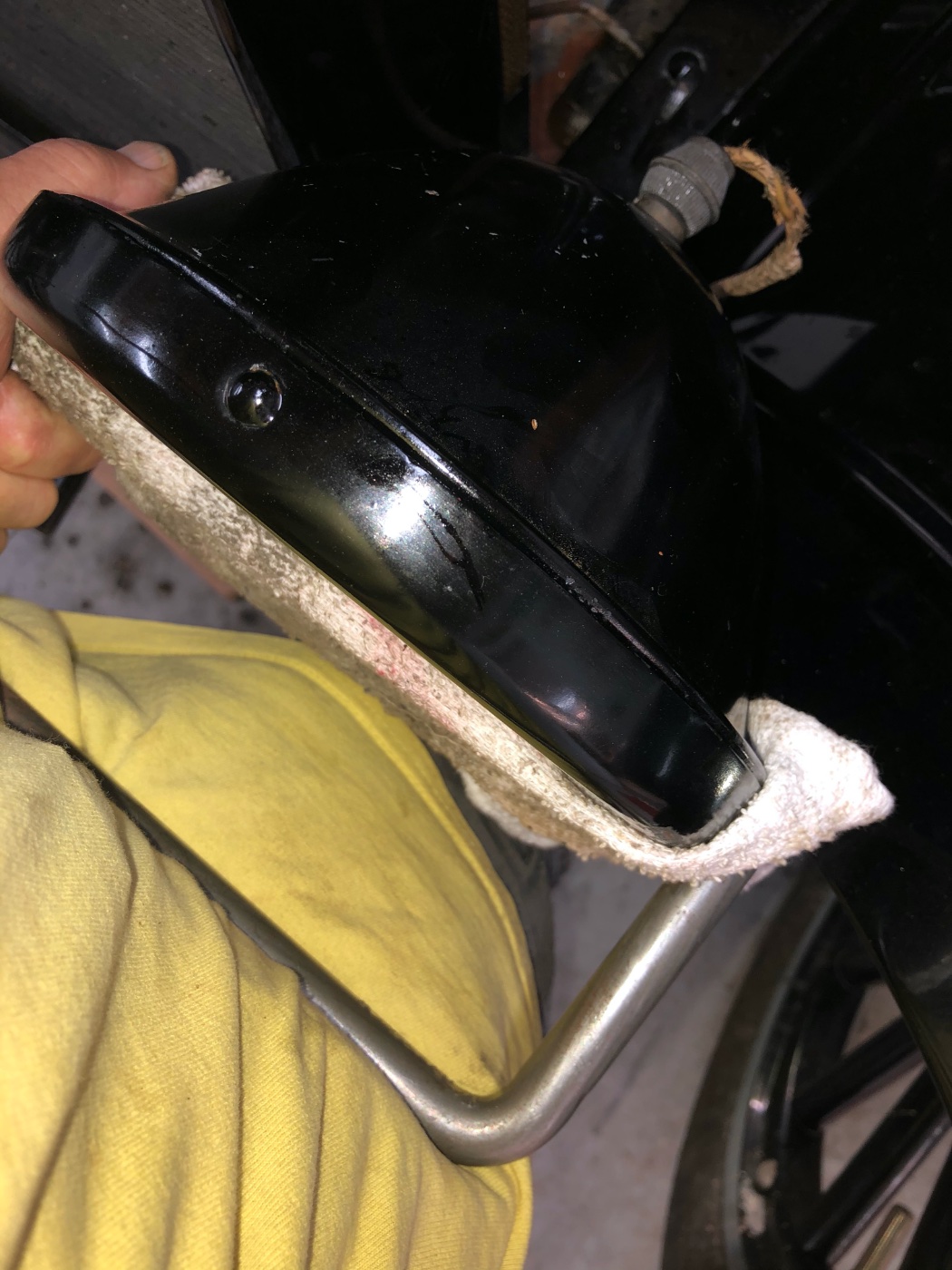

Using the rim tool is helpful IMO. Wrap rim with a rag first to give more friction contact for the rivet head recesses in the tool.
Then push, very
hard, using your hip or gut, against the tool, and at same time twist the tool, you have to compress the bucket spring against the reflector to allow the bayonet clips on the bucket to release the rivet tangs on the rim.
Then the rim is loose and can be removed.

Had the best luck using a GOOD headlight rim band wrench in the right hand and using my thigh to push in the RIM, then using the palm of my left hand to bump it on along until it relents. Sometimes those old and rusty rim springs can be a (deleted), also make sure you've put Kroil (or something equivalent) along the bucket to rim junction... rust and/or corrosion is not your friend.

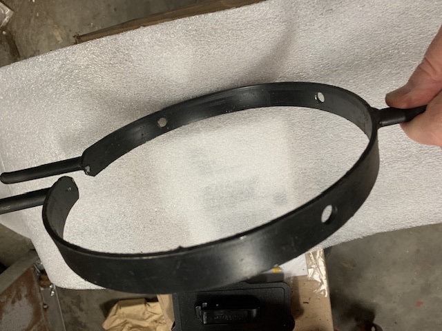

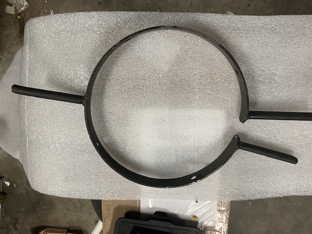

These were made by a couple of our forum members a few years back. Work great!!!!

Look in the Service Bulletins. You will find the tool like I posted and later the tool Dan T showed.

Checking Lang's catalogue, I see only the tool Dan Treece posted. Preferring the other type, I made mine hinged so it comes apart to fit in my under-seat tool box. Used properly it gets a good, solid grip on all four rivets.

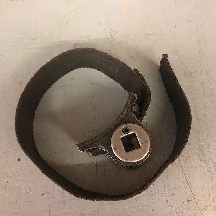

I use something you probably don’t have. It’s a strap type filter remover. This is without a doubt the best tool to use on stubborn headlamp rims. Grips evenly and works like a charm. I usually put a rag under the metal section. The free end of the belt slips into a slot that’s under the square drive hole and cranks it tight. The more it tightens the harder it cranks the rim.

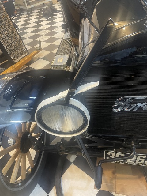

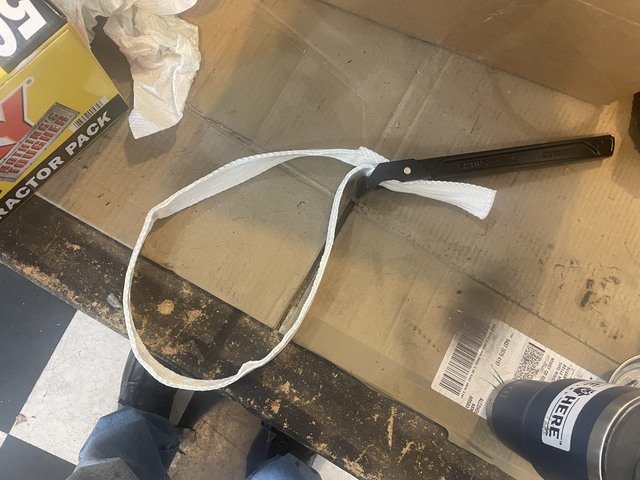

I had trouble getting the rim on my bucket. I got this strap wrench at Home Depot, Husky brand. Super soft, I just got the car painted. On and off with just a pop. It has a long strap, 34 or so inches. I think it was $25 or so.

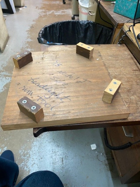

I made mine out of wood. The blocks catch each rivet. You simply push and hold some pressure on the base, and twist it, and it releases the rim on my 1915 every time, with no scratches or damage.

Yes they work great but a bear to make. Time and materials made making many for sale not profitable for what people would pay for one. We made a few and just gave them away to friends. You were one of the lucky ones!
