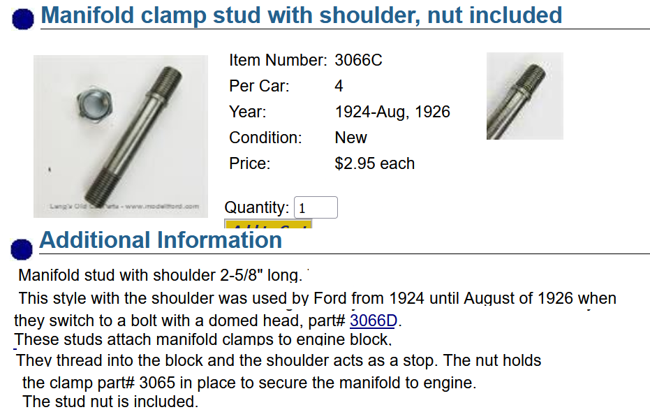

I have never seen an original manifold bolt. There were different length manifold studs. The later style with the two way mounting clamps on the improved cars were shorter, and most had a shoulder on the end which was screwed into the engine block.

Here are original manifold bolts for the late T, nickel plate dome head.
And the two types of studs, the shorter stud for the '24 and later 'recessed' or butterfly clamps.
With the new style in '24 of the recessed clamp, Ford engineers designed it to also fit an early engine with the longer studs, just reverse the recessed clamp for a long stud.

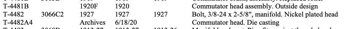

That 'stud' is just Ford's price list lingo, it was a bolt.
Should have pulled this screen shot from Bruce's C-D encyclopedia. Even gives the length that OP wanted

Steve
With respect can assure you, the last manifold clamp fasteners became bolts with dome heads. Many '27s have these, have seen plenty.
The Factory Numbers are there for the nickel head bolt, so that is the specification.
Factory No. 4482 for the Part # 3066C2 Bolt, nickel plate dome head 2 5/8"
Factory No. 516B for the Part # 3066C Stud 2 5/8" for the new style 3065 'reversing clamp'
Factory No. 516 for Part # 3066 Stud 3 1/4" for the earlier clamp
Lots of times the illustrations in the Price List of Parts won't match as they can be earlier pictures, most times the newer parts may or may not be listed and without updated illustrations.
