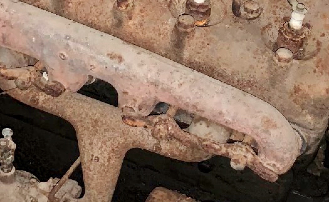

Hi all,
Can someone tell me what is the correct length of the bolts that secure the intake and exhaust manifolds to the engine block? Thanks,
John

I have never seen an original manifold bolt. There were different length manifold studs. The later style with the two way mounting clamps on the improved cars were shorter, and most had a shoulder on the end which was screwed into the engine block.

Here are original manifold bolts for the late T, nickel plate dome head.
And the two types of studs, the shorter stud for the '24 and later 'recessed' or butterfly clamps.
With the new style in '24 of the recessed clamp, Ford engineers designed it to also fit an early engine with the longer studs, just reverse the recessed clamp for a long stud.
