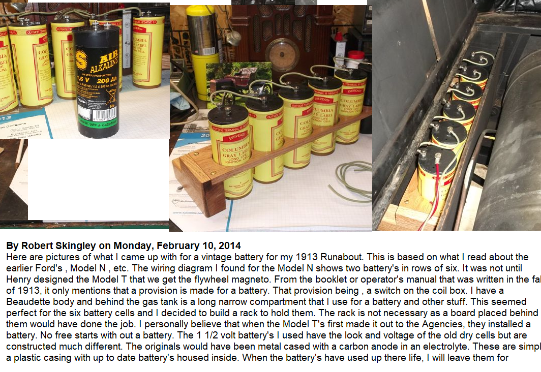

Being authentic non-starter setup
http://www.mtfca.com/discus/messages/41 ... 1391269200

Awesome!TRDxB2 wrote: ↑Tue Apr 01, 2025 1:15 amBeing authentic non-starter setup
