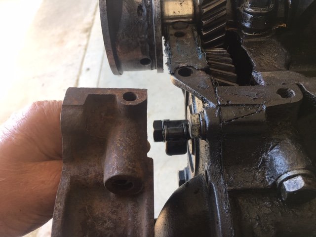

Norman, You can see the crack in the generator housing on the right  in this photo.  The spare housing I have is on the left.
You can see that debris or oil in the housing bolt hole can cause a crack due to hydraulic pressurization in the closed hole design. My spare cover had the hole drilled so it is open in the rear. I think this will prevent a future crack.
