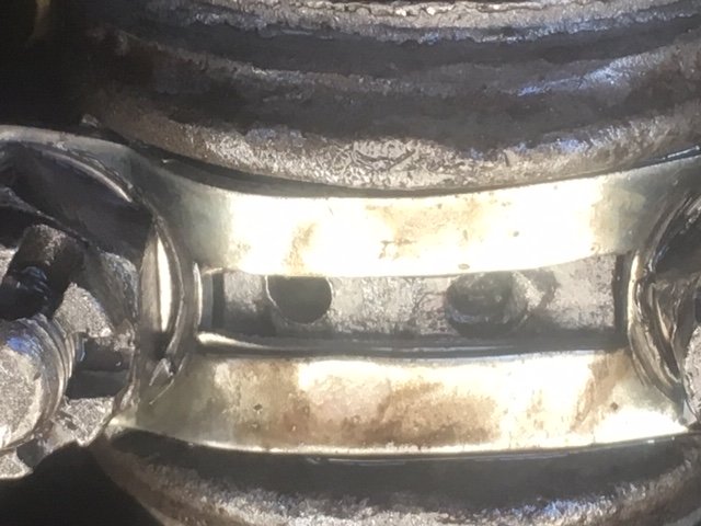

First the oil modification mention: When I build up a T engine I add rod scoops to help oil the bearings. This is similar to what Chevrolet did and is a debatable modification. I use the commercially available tin scoops and drill the rod cap. The first thing I do is to gently (?) widen the opening and squash the height down. The goal is to increase the cross sectional area of the scoop and decrease the height. The idea is to move more oil and be able to clear the "Horlick Mountain Pan dips" I usually utilize.
I lost the bearing on #1 rod because it is a long steep uphill drive in to town and for the first time in about 18 years I've been running without my pan dams. I have no additional oil lines at this time going stock some time ago. If I pull off the flywheel I will probably add a second interior oil line.The dip on #1 was intact.
Oil scoop spread and ready for service
oil scoop
oil scoop
I noted that the scoop on #3 had failed. It had sheared off where the scoop passes through it's base.
broken scoop
broken scoop
I have no Idea when the scoop came apart nor where it went. At first I naively thought it was involved in the clicking noise. I hope to find it in the t-cup at the bottom of the pan when I look there.
I have now found two problems with the scoops. First is that when you reshape them the chrome plating flakes off into your oil (and bearings). Second, now, the scoop can be weakened and caused to fail. My next set of scoops will get annealed to remove the plating and allow reshaping without cracking. Next they will be annealed again before installation.
