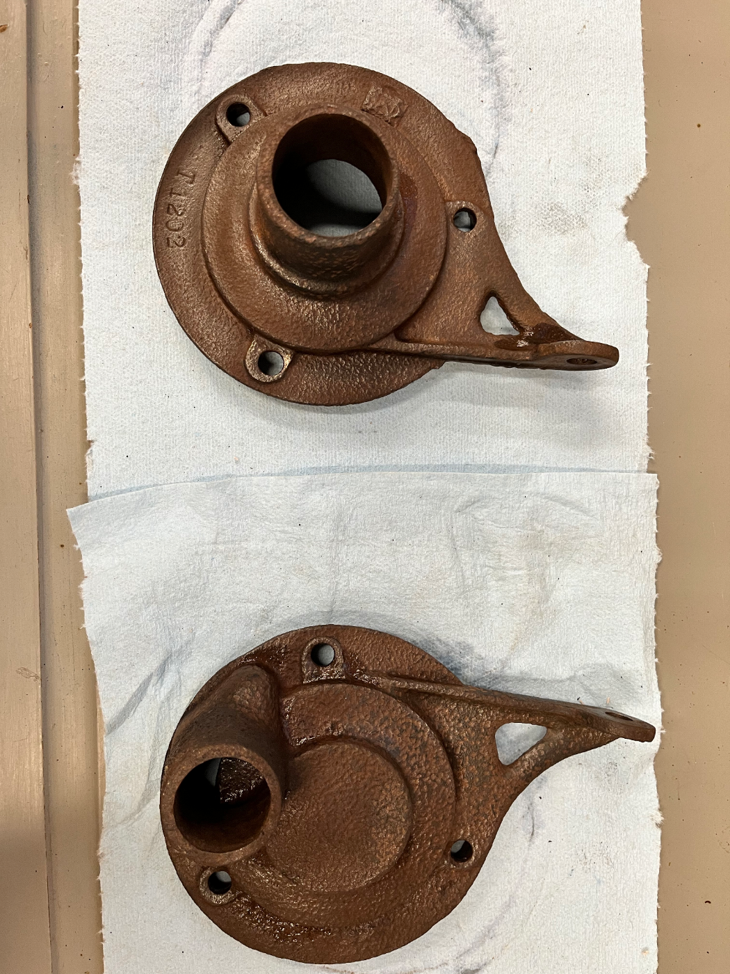

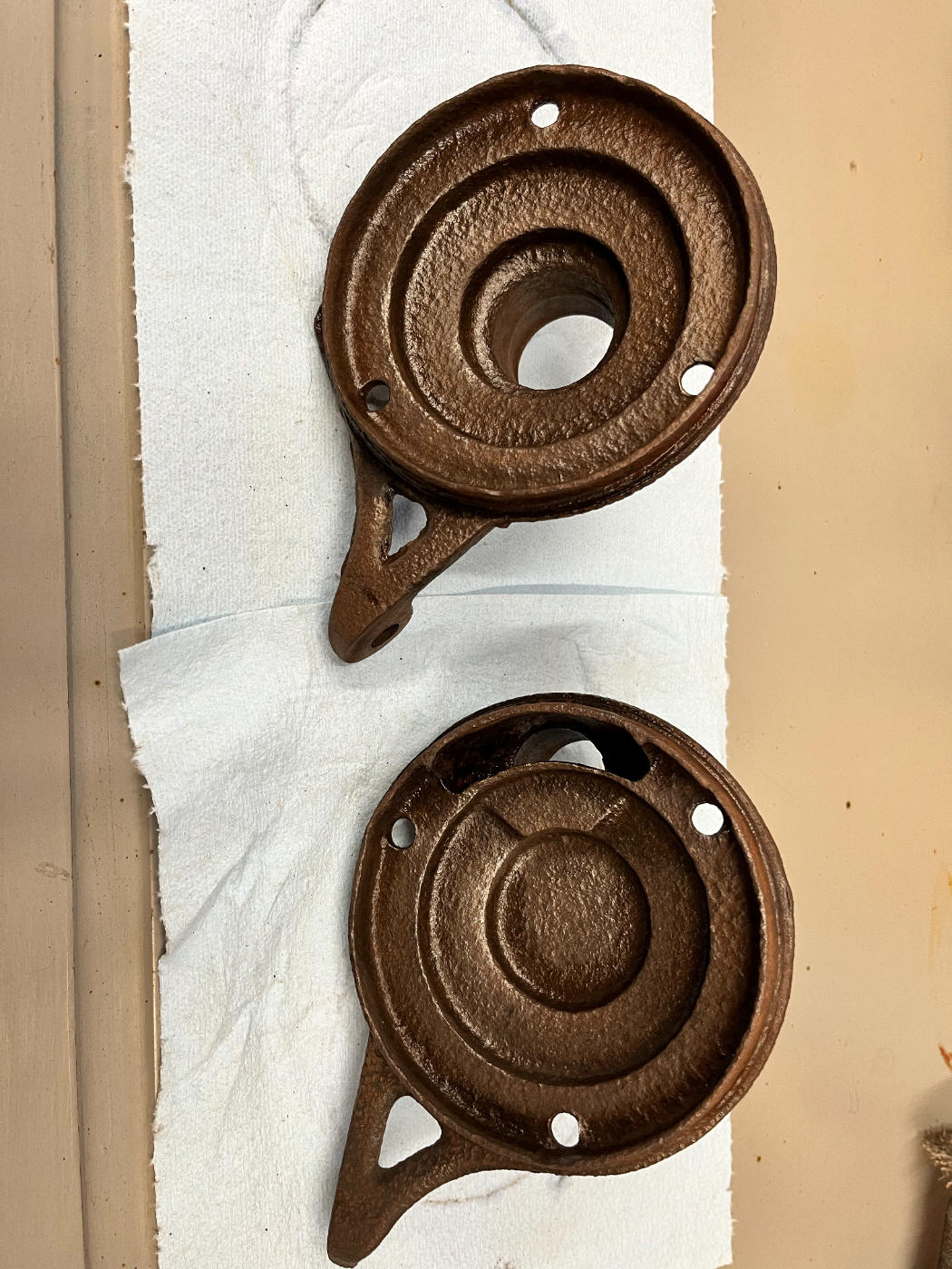

Was able to salvage my cast iron ends.... would like to reuse them with a new shell kit (3-bolt).
will see if I can get a little more knocked off them, then maybe paint them with high-temp paint (black)

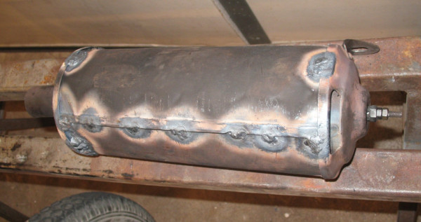

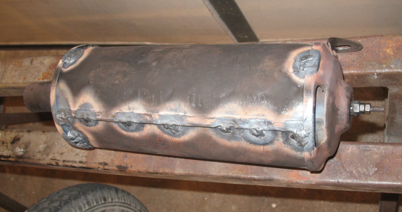

From photos of repro shells posted here at times, they are not made with the correct folded seams. The joint overlaps and is spot welded to hold it together. Some add their own welds along the seam so they don't blow apart. I could send you the two larger ones correctly made with folded delivery seams, but the beautiful new tariff would add $80 to the cost. You know who to thank for that.
Over lapped seams leak, shells leak at the ends the pipe leaks at the front end, so a coat of high temp exhaust paint will make them almost disappear from view.

Your cast iron ends look to be in great condition. Give them an overnight soak in something like Ospho to help descale
(Might be anal, but after soaking in acid I always neutralize by following up in a water bath with baking soda, then rinsing). Paint as you will with high temp..

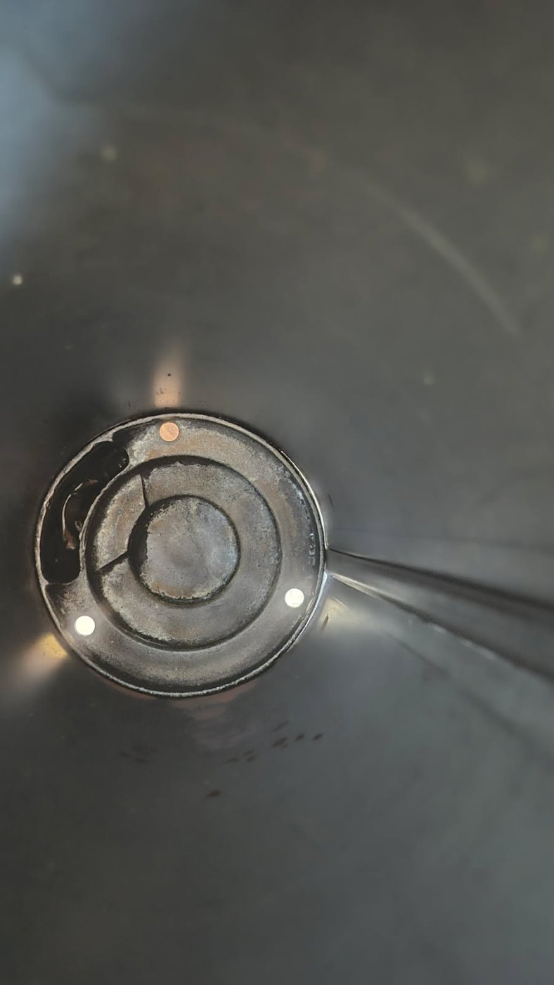

I recently bought a new shell kit for my '14 3 bolt cast iron ends.
First thing I noticed was the shell bows out at the seam sufficiently where a tight seal would not be attained, creating a major exhaust leak at both ends.
I did NOT want to use something more permanent/hard like JBWeld to fill the gap, that just spelled major hassle down the road in my mind. I used a high temp RTV (way easier to remove than JBWeld, but also flexible)... I used Permatex Optimum High Temp RTV. Hopefully I never run too leaned out to glow that muffler past 750 degrees.
Perhaps others have different solutions....

Spot welding worked for me. No more cobbling the thing back together out on the road. I knew it would last for years, and if it eventually went bad another new one wouldn't break the bank. I would spot weld that one too. A man's gotta do what a man's gotta do.
