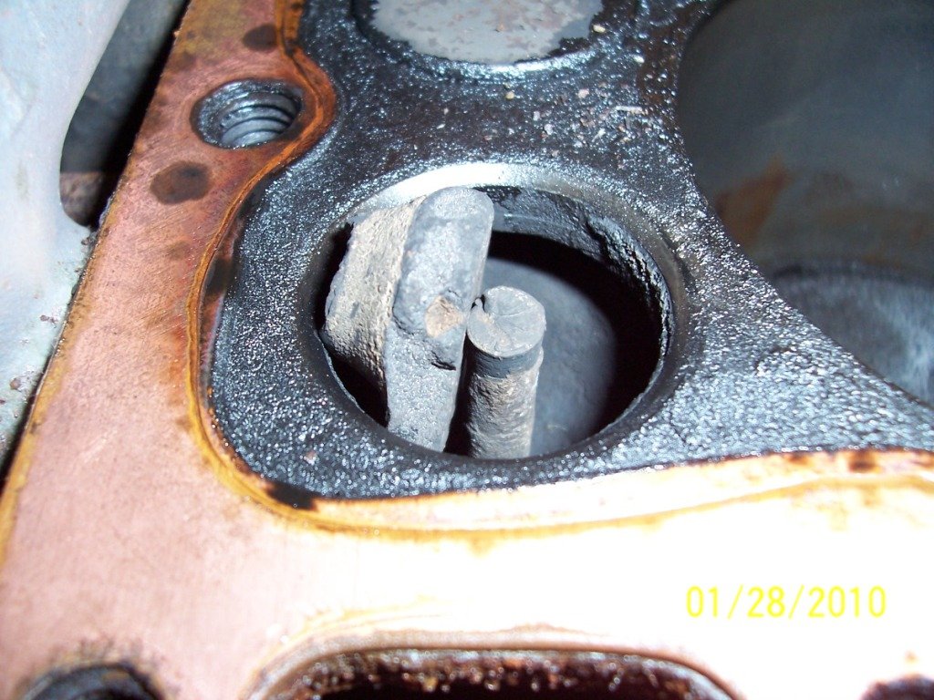

I want to verify that these are two piece valves. They have the two holes on top. Art
big2bird
- Posts: 725
- First Name: Jeffrey
- Last Name: Hausey
- Location: Anaheim, Ca.
Re: BAD ROD ADVICE
Yes........
- Posts: 5245
Re: BAD ROD ADVICE
Verified....
