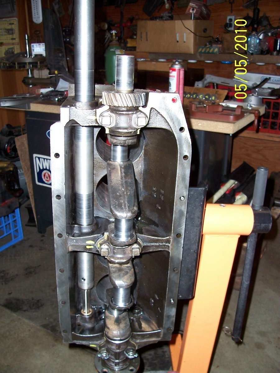

This is mine. I have multiple standard and undersized reamers. I think these are jig bore reamers. Had it made so it can be powered by a drill motor, wrench or piece of bar stock. Cost about $250 to have it made locally. May be a little too far from you though.
Brad
Brad

Here is the numbers on mine. Looks like it maybe a Z tool?
