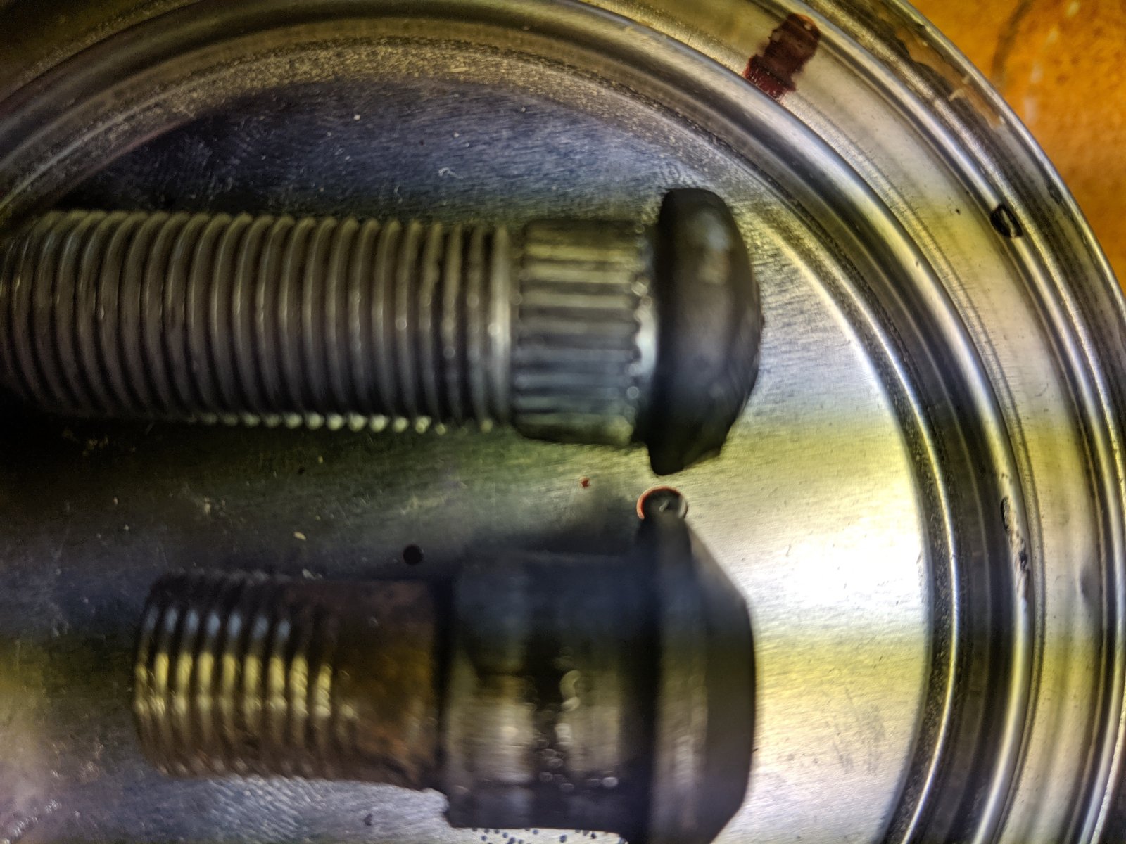

I had a "moment" and caught a nut with my magnet. It was on a rag near the flywheel.
I later dropped a cover screw on the ground and grabbed my magnet to get it...no sticky !!
Here the end of the magnet had came out and stuck to the flywheel !! Had I not dropped the cover screw, bad things may have been on the horizon. Grabbed it with needle nose pliers, all good.

After seeing pics of the destruction that leaving even one rag behind can do, i use an old twin sheet just for this occasion. Plenty of material to stuff every nook and cranny of the trans, with some to spare. When done, pull it all out, no counting needed. ;)
Experience is a wonderful thing. It enables you to recognize a mistake when you make it again.

Passenger side hit a snag though. The hub is a slightly smaller diameter than the drivers side and the lug holes are a smaller diameter than they should be so I can't press it onto the new drum/disc. And there's a tag on it that says "Made in Hong Kong."
And everybody seems to have wire wheel rear hubs on back order. So there's that.
I've been thinking about taking this hub over to a pretty good machine shop over here and having the lug holes widened to the correct size.
