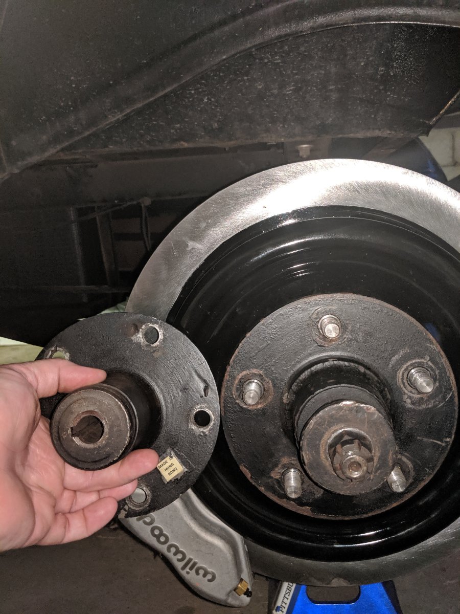

So there I was last Friday beginning the installation of my new disc brake kit. I had made good use of the 10 days since I sent in my brake pedal for modification by gathering my tools and preparing the work space, so when the kit arrived on Thursday evening along with my modified brake pedal I was ready to jump right in on Friday.

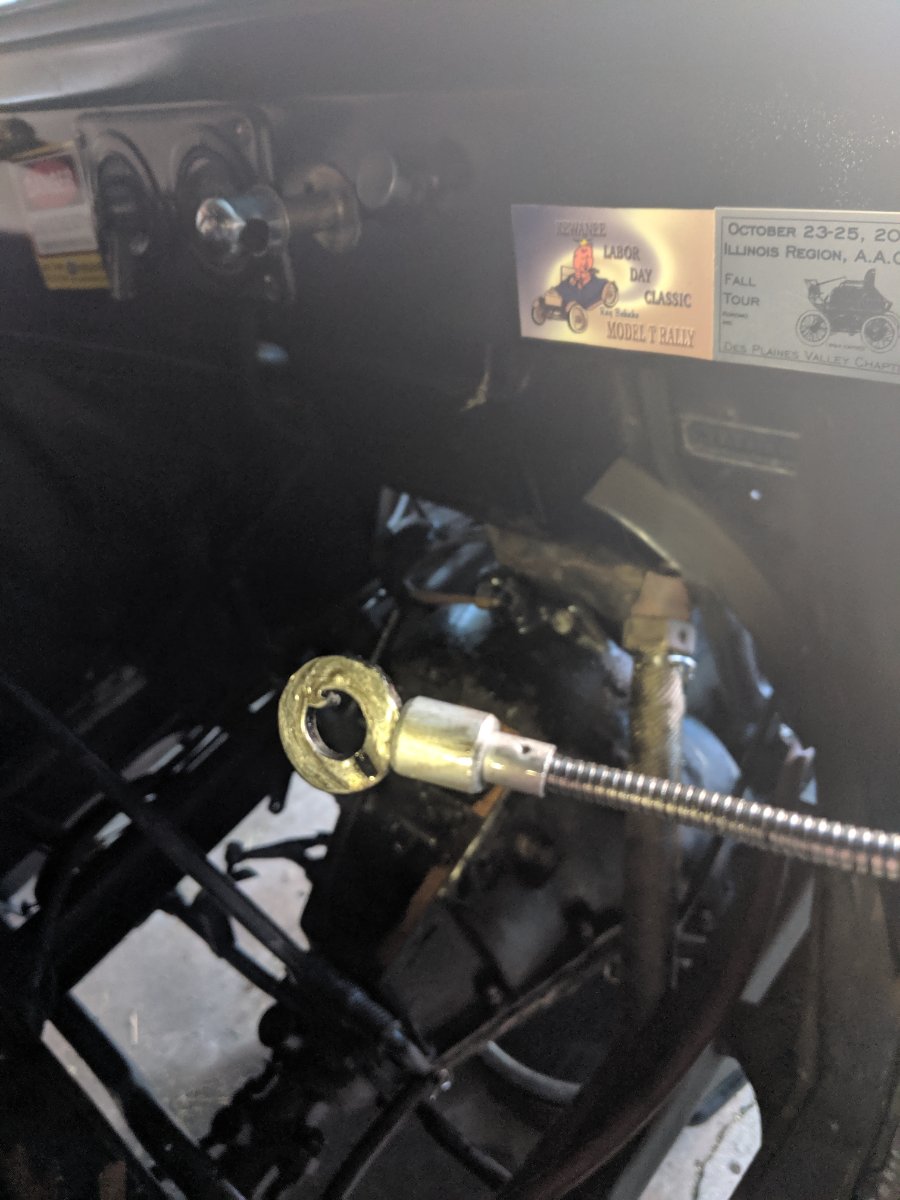

Having learned my fate, I went and bought the only two such telescoping magnets in stock at my nearest big box store, one large, one small. I bent the shafts to get around the drums and spent the next two hours fishing around to no avail. I stopped trying when one of the shafts split and I was afraid of it breaking off down in the transmission.
Next, I drained the oil to try and drive the washer down to drain hole. This was particularly annoying because I had just changed the oil last weekend and had only driven about 15 miles. I crammed my fingers in that hole to feel around but found nothing. I used a strong magnet all around the bottom of the pan to try and drag the washer to the drain hole. No dice. I shoved a stiff wire in the hole to feel around, trying to locate the washer. Nothing.
Before removing the hogshead I searched everywhere for a flexible shaft magnet and found one in stock at a big box store 30 miles away. When I got home I fed it into the transmission and began fishing. The flexible shaft was much easier to work with and got around in there much better than the telescoping shaft.
And I began to get aggressive. I was annoyed, angry, and despondent and I wanted that washer out NOW. You know what happened next.
The flexible shaft magnet got hung up towards the front of the transmission; it would move down a little bit, but would not come back up. I stopped, stepped away from the car and put my head down.
My hopes of solving this problem myself were dashed. I was going to have to pull the engine and I was going to have to wait until I could get somebody that knows what they're doing to help me.
Despair set in. Forget about the new brakes, this car was probably not going to be running again this year, because when you start mucking around pulling an engine like this you always find other problems that need to be fixed and then you're off to the races.
I had failed. Because there were no additional steps I could take by myself, I began fooling around with the stuck magnet. Oddly, a sense of calm despondence came over me; I was resigned to my fate and had nothing more to lose. I began gently pushing and twisting the magnet shaft.
Did it just move a little more? My mind must be playing tricks on me. More gentle pushing and twisting. Did it just come out a little bit? I think so, but it's still stuck. Hmm, more gentle pushing, pulling and twisting.
Whoa! The magnet shaft moved freely! Was there hope for me after all? Ever so gently I withdrew the magnet shaft, praying that it would not get stuck again, that I wouldn't make another terrible mistake of judgment.
And as the end of the shaft cleared the transmission bands and came up out of the access cover, there, attached to the magnet, was the washer.
I stepped away from the car, placed the magnet with the washer still attached to the end on the running board, and sat down on my shop stool not with a sense of accomplishment or victory, but of quiet gratitude.
After a few minutes composing myself I got up, stuffed about 15 rags around the transmission bands, clamped the band with a drain wrench that was sitting with my plumbing tools not 20 feet away the entire time, and successfully completed the brake pedal installation.

Sweet! I have an older flexable shaft magnet, the head is longer. Yes I too have had to use it
With mine I have found that sometimes it gets hung up on the starter ring gear teeth.
Re rags, don't always count on them!
I have had at least one time that the washer or nut found the only spot that was not even close to where I was working and found it's way into the murky depths.
If you drained the oil into a clean pan, reuse it.

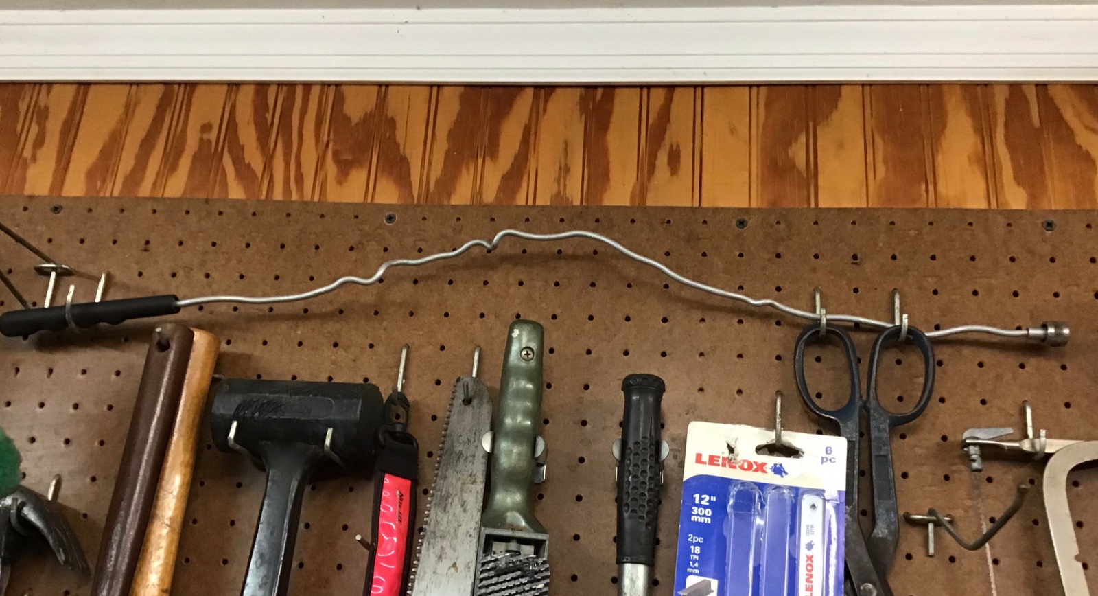

Use only floss now, but with two strands on each nut and washer over the abyss under the trans. cover.
And keep that tool at the top of the pegboard, like a fire extinguisher, just in case

Mac tools sells a flexible shaft magnet that's fantastic for these situations it's about 20" long made from a 1/8" soft aluminium shaft with a knurled handle the magnet is only 5/16" around & 1/2" long. It's strong enough to pick up a 9/16" wrench. I keep one at work & at home. There pricey at about $20 but work great. I use one all the time for things other than fishing washers out of Model Transmissions. Really I do.

We managed to drop the "Shift nob" for the Ruckstel shifter into the transmission. yes, we amateurs that we are, had the cover off. We have drained the oil, made wire grabbers and pushers out of coat hangers, and felt around with our fingers from the top and up the drain hole. We cannot prove to ourselves that it is even in there and my partner swears he was it fall in. Our T sits on a concrete slab with nothing near it, so we would have seen it if it fell somewhere else. I have been under the car and looked and felt everywhere. Please, does someone know something else we can try before we have to pull the transmission. Could the knob have made it's way into the pan ?
- Posts: 5270
Re: "Pride Goeth" or "The 15 Mile Oil Change."
Get a half dozen of your biggest buddies, a case of really good beer, drink beer then flip the T over & shake the SH_ _ out of it !
Had a buddy actually do that with an excavator - band nut dropped back out !

Maybe try a camera for tight spaces. Thats a pretty big object not to see with a scope camera. I have dropped things and spent hrs looking for it to find it later on the other side of the shop.

Only one guy claims that he saw it fall in there, hmmm? Did he maybe then sit on a bucket drinking beer while you were rooting around in there looking for it?Jed wrote: ↑Mon Jul 15, 2019 1:05 pmWe managed to drop the "Shift nob" for the Ruckstel shifter into the transmission. yes, we amateurs that we are, had the cover off. We have drained the oil, made wire grabbers and pushers out of coat hangers, and felt around with our fingers from the top and up the drain hole. We cannot prove to ourselves that it is even in there and my partner swears he was it fall in. Our T sits on a concrete slab with nothing near it, so we would have seen it if it fell somewhere else. I have been under the car and looked and felt everywhere. Please, does someone know something else we can try before we have to pull the transmission. Could the knob have made it's way into the pan ?
Seriously though, I don't see how there's room for a shift knob to fall all the way down in there. Seems like it would at least get hung up on the clutch forks or the side of the drum.
Here's a few annoying questions: Did you check the lip between the base of the Ruckstell shifter and the transmission? How about under the car resting on the inside of one of the tires? (The knob is black and it might blend right in there if you're not looking for it.)
Like Dallas says, maybe try a borescope.

Quick update on the install of the disc brake kit install that started this thing:
I got the assembly installed on the driver's side without incident.
Passenger side hit a snag though. The hub is a slightly smaller diameter than the drivers side and the lug holes are a smaller diameter than they should be so I can't press it onto the new drum/disc. And there's a tag on it that says "Made in Hong Kong."
And everybody seems to have wire wheel rear hubs on back order. So there's that.
I've been thinking about taking this hub over to a pretty good machine shop over here and having the lug holes widened to the correct size.
