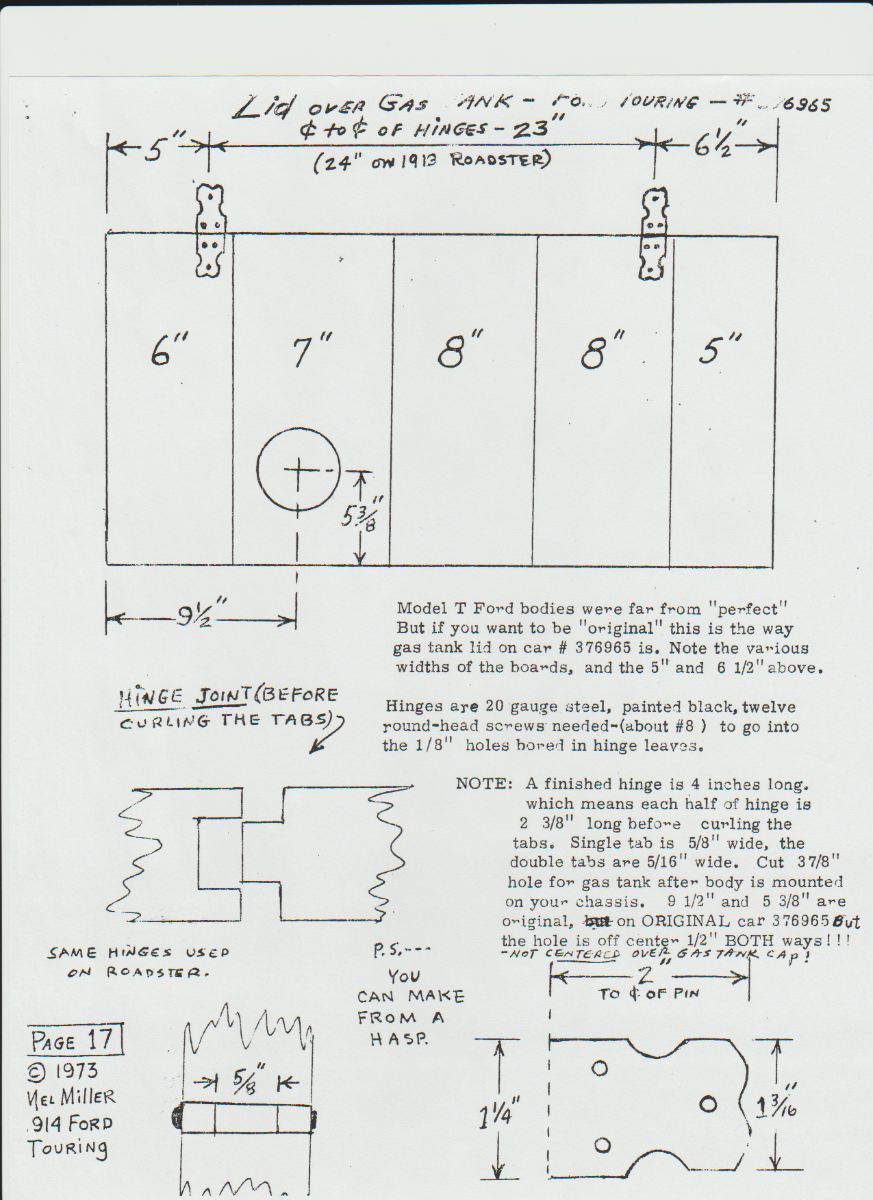

I am in the process of wooding a 1914 Roadster body with a kit I purchased. There are few instructions or illustrations. I am in need of photos of the seat wood framework that is just above the fuel tank. I believe the wood lid that covers the fuel tank and is just under the front seat cushion is rectangular. The dimensions of that lid would be very helpful. It appears that there are a few wood pieces that are incorrect. I thank you in advance for your help!

Here’s my ‘14 runabout under-the-seat wood: the ‘lid’ measures 31 1/4” X 14 5/8”. This body was reworded by Ray Wells aka The Craftsman.

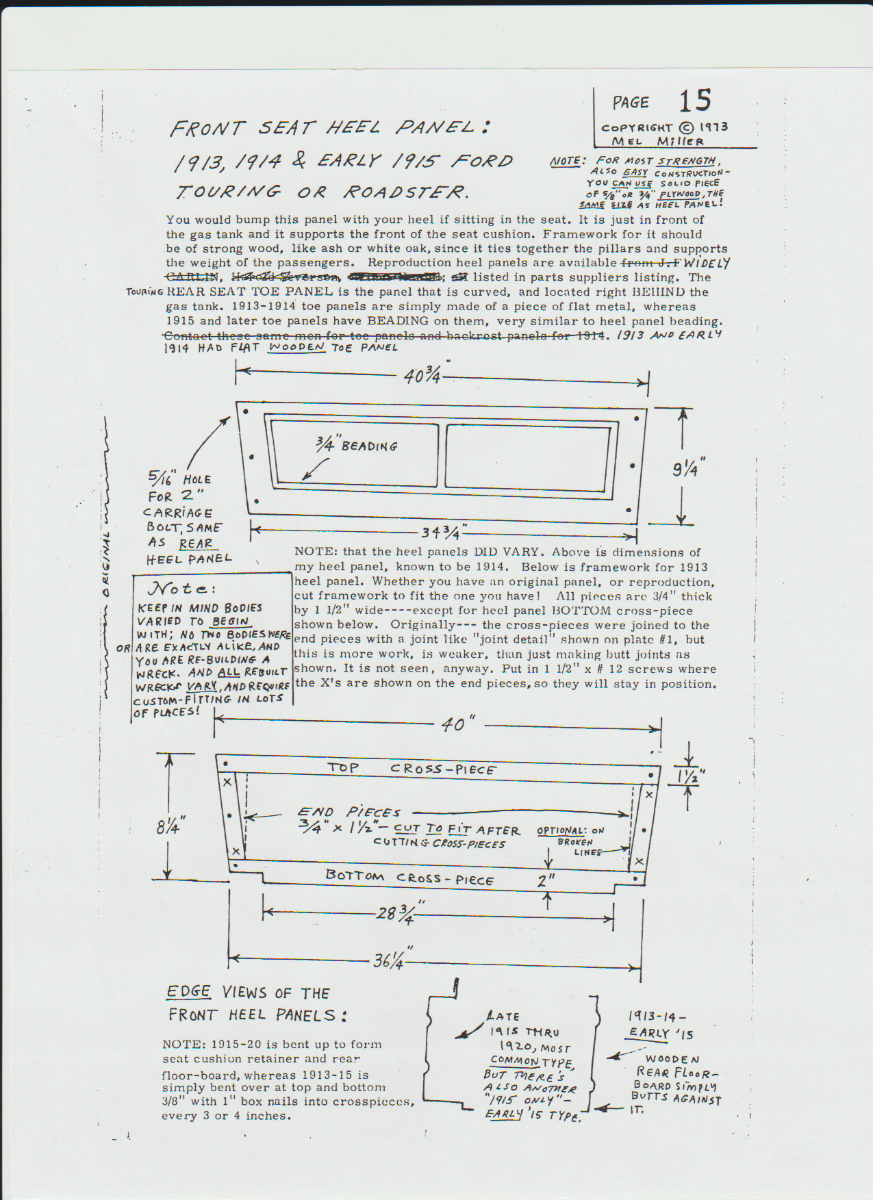

Colin Mavins
Posts: 187
First Name: Colin
Last Name: Mavins
Location: Winnipeg Canada
MTFCA Number: 1853
Re: Need photos of 1914 Roadster body wood
Post by Colin Mavins » Sun Sep 08, 2019 10:30 am
these are from the 14 touring -roadster plans Cheers Colin
