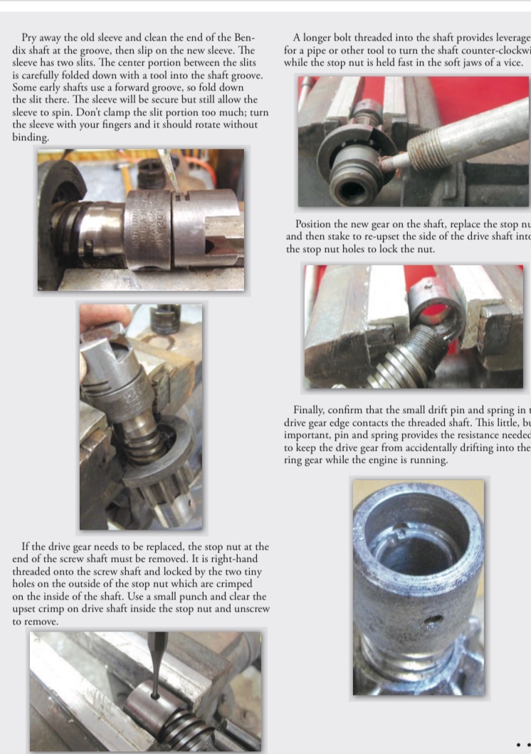

[attachment=1]image.jpg I’m trying to take a starter drive apart. Dose the bearing press off?

No not pressed on, it is threaded on then staked on from the inside into the two small holes.

Thanks, Is it a right hand thread? Thanks again.
Posts: 3819
* REQUIRED* Type and Year of Model Ts owned: ‘12 open express,'23 cutoff, '27 touring
Re: Starter drive disassembly?
Post by DanTreace » Sun Oct 13, 2019 1:42 pm
Right hand thread. Here’s a how-to:

It can be done with no special tools. I cut two round head nails just below the heads and these short bits go in the holes in the bearing. Then the bearing is held in the vice between aluminium soft jaws, the nails being there to stop it turning in the vice. A large pair of slide joint pliers engage on the gear to wind the assembly apart.
